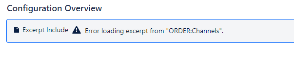

In the new editor, we are using the excerpt macro to pull info onto a page in a different space.
It appears to work--I can nest the Excerpt macro in the Expand macro--but on the new page, it appears as "Error loading excerpt" and has a scroll bar.
The content does appear if you click the expand arrow, but we don't want the error to appear, or the scroll bar.
Anyone else run across this issue?

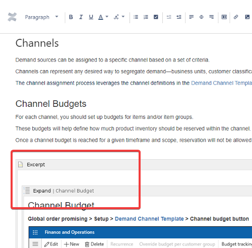

Megan Stanage
April 26, 2022
Megan Stanage
April 26, 2022
Megan Stanage
April 26, 2022
The two above screenshots are an expand in an excerpt. Same thing happens if I switch the excerpt into the expand.
Brant Schroeder
April 26, 2022
@Megan Stanage Thanks for the screenshots.  You are on server by the looks of it.  My guess is that the content in the expansion is causing the issue.  Are you using an additional macro inside the expand?  Have you tested using just some basic content like text (This should work)?
