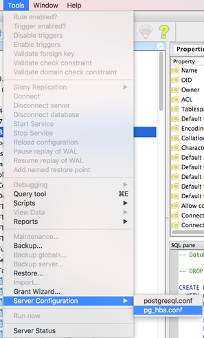

@SACHIN MENON you may edit the pg_hba.conf file from pgAdmin by using the Tools menu and choosing Server Configuration>pg_hba.conf:

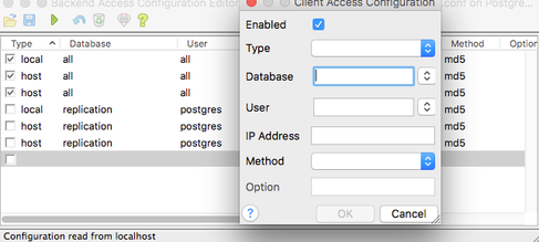

To add a new line, double click the blank line:

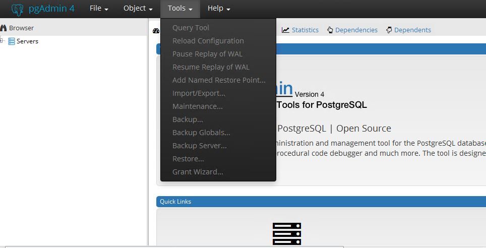

SACHIN MENON
November 21, 2017
SACHIN MENON
November 21, 2017
Thanks Ann for your response. I fear I am not seeing the server configuration option under tools as you can see in the snapshot which I have shared. The one which I have is pgadmin ver4 on windows and I believe the snapshot which you shared is based on non-Windows platform.

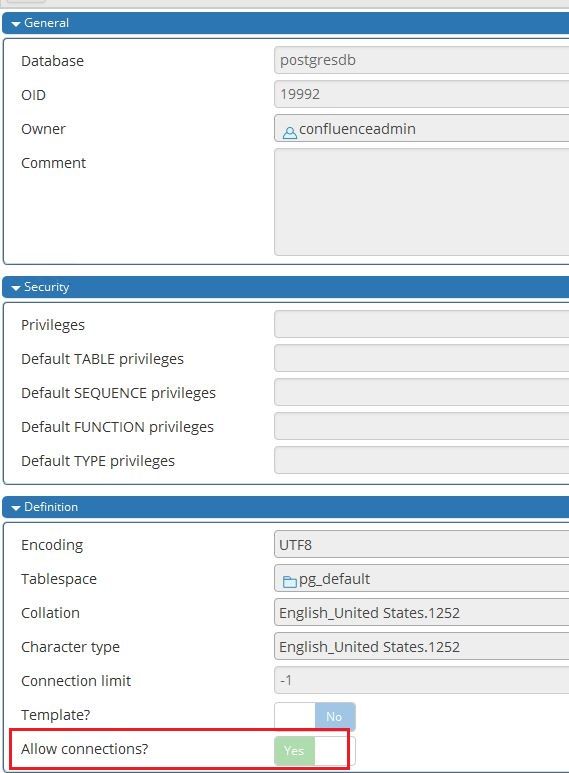

SACHIN MENON
November 12, 2017
snapshot.JPGsnapshot2.JPGI have attached the snapshots as well.
