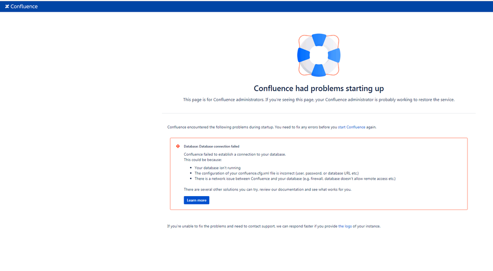

after that, the confluence began to display a database connection error1.png
Maxim Gorbushin
June 26, 2019
but that's not clear, we used the initial version of the database (without sql)
and  i did not delete anything before the problem, what kind of connection to the database are we talking about?

that's what I noticed:
three hours after the launch of confluence, this is what appeared in the log file (see attach)
