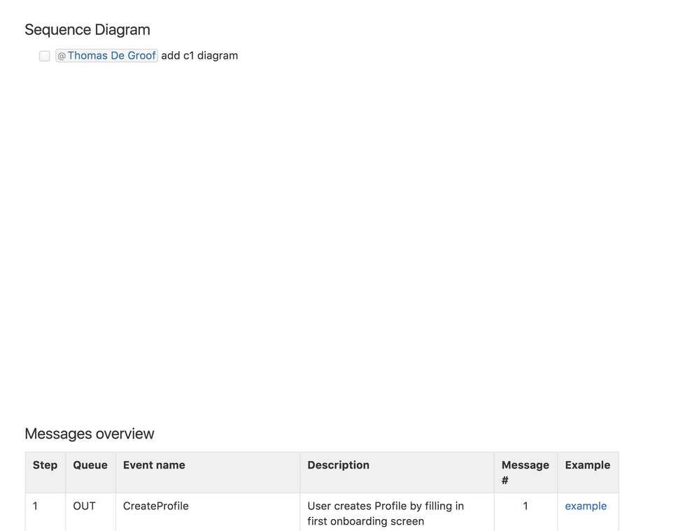

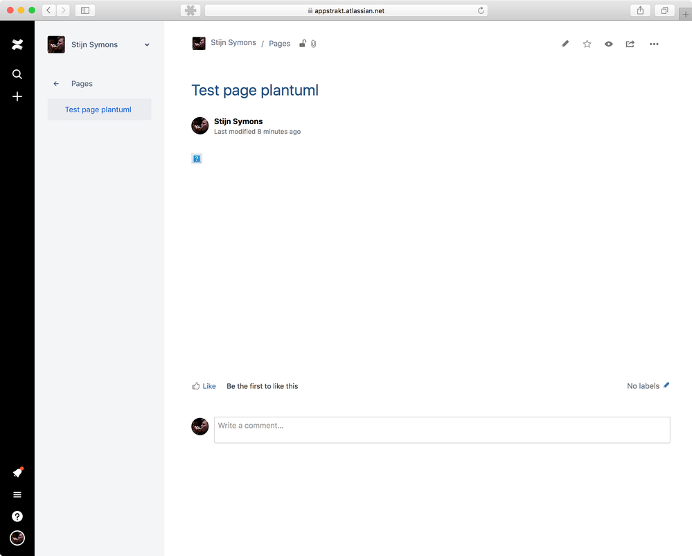

- no image is rendered on the page (neither after publishing) - see screen belowScreen Shot 2017-10-13 at 11.25.38.png

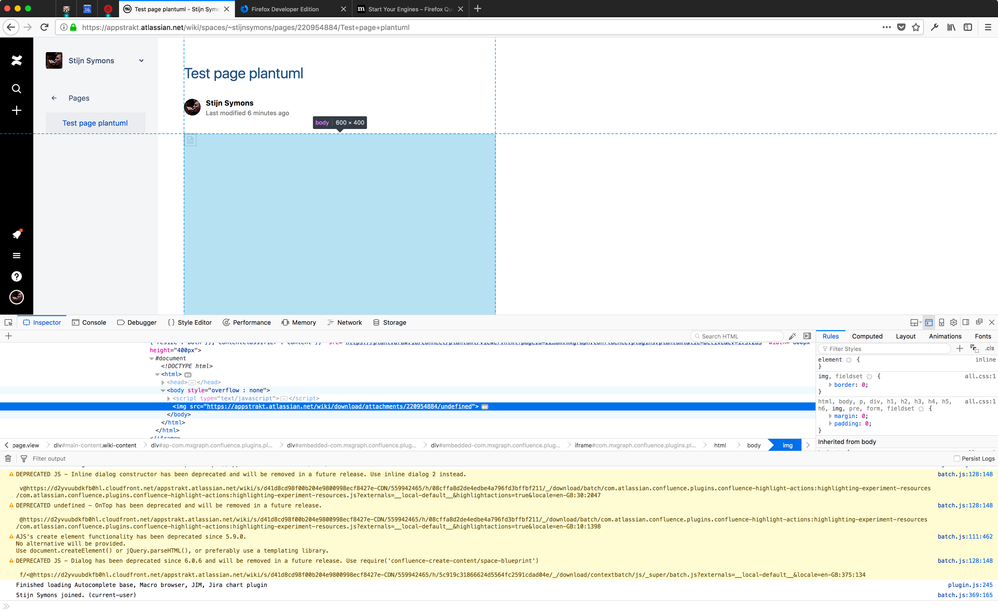

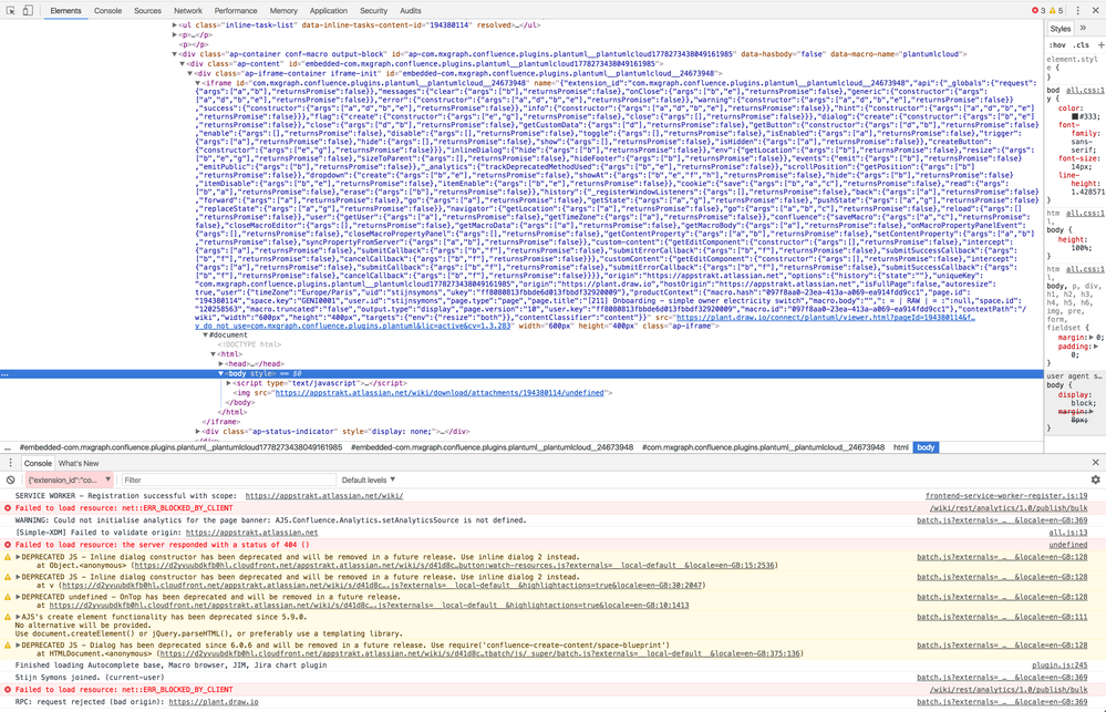

- Devtools has some error messages, iframe ends into an image named "undefined" which does not exist

- Issue is for all our users
- tested on chrome, firefox and safari on mac - all have the same behaviour, in the end it loads an iframe with a /undefined as image
Screen Shot 2017-10-16 at 10.29.39.pngScreen Shot 2017-10-16 at 10.26.21.png

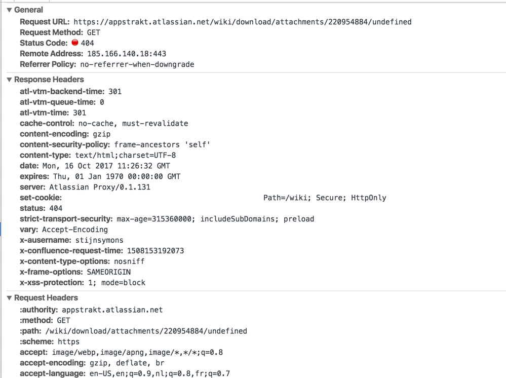

Could you show me, in the network tab, the requests that returned those 404s please?
Stijn Symons
October 16, 2017
below the details of the request call to the actual image. (redacted the cookies)
