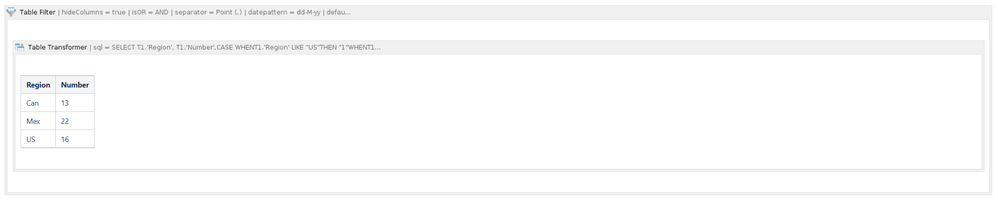

The Pivot Table macro sorts your items alphabetically, but it seems that your need your own custom sorting. So, here is a workaround - I'm not sure if you have Server or Cloud, so for the first option just nest your macros directly and for the second option use the Table Toolbox macro (other steps are the same).
Wrap your Pivot Table macro into the Table Transformer and then into the Table Filter macro:

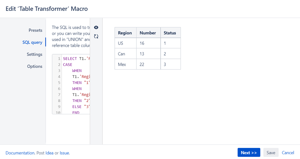

Use the Table Transformer macro to assign additional numbers to your items:
SELECT *,
CASE
WHEN
T1.'Region' LIKE "US"
THEN "1"
WHEN
T1.'Region' LIKE "Can"
THEN "2"
ELSE "3"
END
AS 'Status'
FROM T* ORDER BY 'Status'

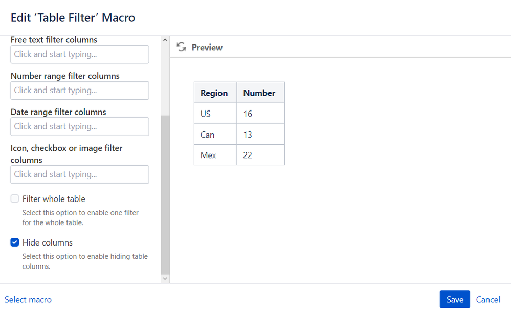

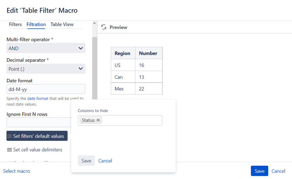

And then use the Table Filter to hide this additional 'Status' column if necessary:
Here we've checked the Hide Columns option in the Filters tab and chosen which column to hide in the Filtration tab -> Set filters' default values menu:

The solution you have suggested is exactly how I had manipulated the sorting order up till using the Table transformer. I then use the Pivot table to read this table transformer data and display it. I have not used a table filter.
Please advise if I have to use the Table Filter to achieve my goal here?

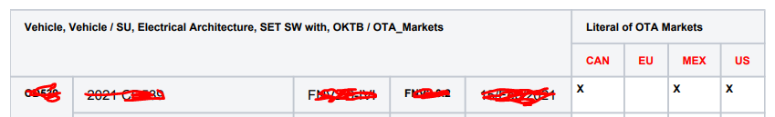

This is my format. Will I be able to preserve this format by wrapping it in Table transformer?
Katerina Kovriga _Stiltsoft_
November 22, 2021
With such multi-dimensional pivot the format will be ruined - the Table Transformer may combine the merged cells in the headers and you'll get smth like 'Literal of OTA Markets US'.
And you'll need another query to rename your colums and define their sequence - my previous answer covers the rows sorting.
Can you please wrap the Pivot Table into the Table Transformer macro without any SQL queries and make me a screenshot of your modified header row? I'll recreate the table and provide you with a new SQL query.

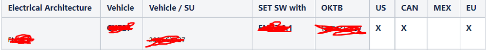

Dolly Kirubavathi
November 22, 2021
The above is after I took the Pivot table and wrapped it into a Table Transformer and renamed the columns. So, thank you! this works...
