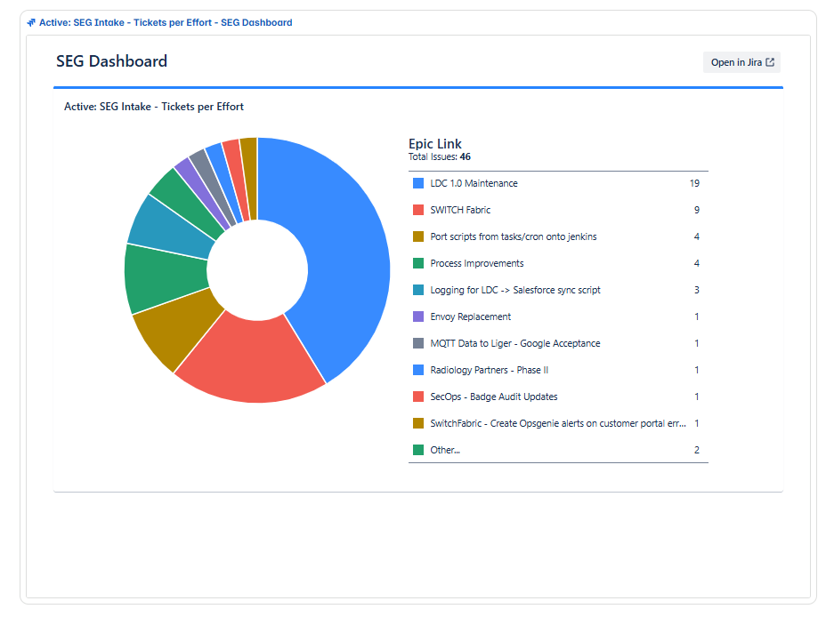

When we view the pie chart in Confluence from JIRA, it has an extended box under the pie chart, taking up space. Our team is looking for a cleaner look.  Is there a way to get the additional box area to not show under the pie chart in Confluence?

Can you provide a screen capture, because I don't have the same behavior, I don't have this extended box under the pie chart of Jira issue.
Do you see how there is space under the line (this is how it is viewed in Confluence? Can that lower area be removed so that we can use the space on the page efficiently?

It seems that you are not using the native Confluence macro jira Chart but inserting the Jira Pie Chart Gadget (use originally in a Jira Dashboard)

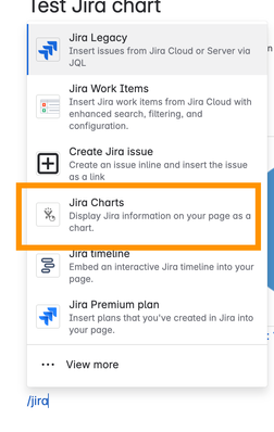

So on the gadget you can do nothing, but there is another solution ! You should use the native confluence Jira macro.
In your Confluence page, insert the macro jira charts
and fill the same parameters than those you put in the Jira Gadget.
