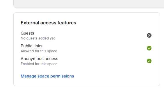

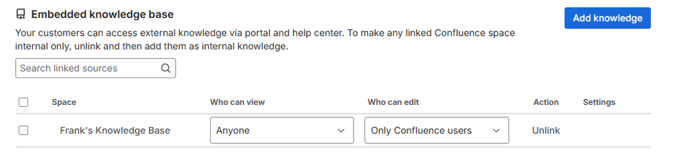

This is currently set up with the following permissions

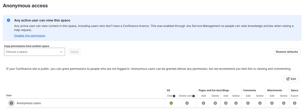

The space permissions for the Knowledge Base say:
We have tried various different settings but our clients can't open the links we've added to our portal or joining emails.  They see the page briefly but then get:

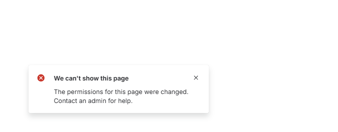

Regarding the topics - we are using links in the way suggested and have added topics to our portal.  The links look like: https://[domain].atlassian.net/servicedesk/customer/article/64389123?source=topic
The link opens correctly in the portal (not Confluence) and briefly loads (the client can see the text).  It then flashes a couple of times, goes white and we get an endless 'whirl' and a "we can't show this page" message.  Screenshot below, any ideas?

  1. whether they are portal-only, guest, or regular users ? Where do I check this? The clients are logged in and can raise tickets. We added them to our account by going to the Space / Customers / Add Customers.  They are assigned to an Organisation that we added in the same way.
    I am concerned now that we should be adding them to following group jira-servicemanagement-customers-[domain] - but will this incur a license?  If so, I don't know how to do this because when I try to Add User to the group, my clients don't appear.
  2. the Knowledge base visibility setting in JSM ? This is set at "Anyone can view" in each Space
  3. the Confluence space access, especially Any active user can view this space ? Do we need to add individual clients to access this? We have it set so that Anonymous Access is enabled.  See below (and we also have "Allow public links for this space" ticked)Screenshot 2026-03-10 090723.png

  1. Where to check customer type ?
    Since you added them under Customers, they are most likely portal customers already. If they do not appear in normal group membership searches, that is expected.
  2. Do they need to be added individually to Confluence?
    Normally not, if you are aiming for KB access through the portal and your KB visibility is already broad enough. I would not start by converting them into licensed users.

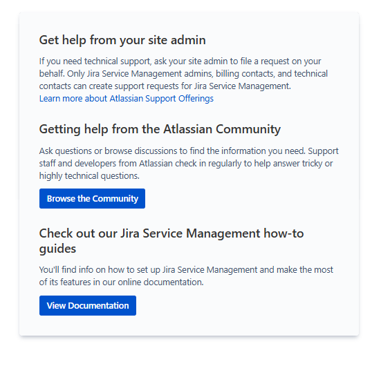

How can I raise a ticket with Atlassian Support?  I tried going to https://support.atlassian.com/contact#/ but when I put in my domain I get this:
When I go to my https://admin.atlassian.com/ I don't see any options for "Help" or Contact.  I've tried the Help search function as well.
Thanks again!!

You noted you are Product Admin
Product Admins are mostly not able to raise Request to Support in name of Companies.
Request must be putted from Org Admin / Site Admin.

Hi,
I should be Product Admin and Org / Site admin - everything is in my name (we only have 20 staff!)
How does the Org Admin raise a request?

Then it looks like someone from your company who configured and created the instance made a mistake. Normally, when you use an account with the required permissions, you should not have to enter the instance name manually. You should usually see a list of connected apps instead.
Atlassian Support
Siobhan O_Leary Donkin
March 10, 2026
Hi,
I set up the account.
When I go to Contact Us, I see all our Apps and I select either Confluence or JSM, it recognises our domain and gives me a green tick.
Please can someone help me contact Atlassian?
We have spent $1000s on this and have been trying to implement is for 1+ years.   This is stopping us from going live and should be simple.
Thanks, S

I am further convinced it is a bug as we have test more today and:
- 2 clients can't see a number of pages (see the error)
- 1 client can see those pages (no error)
They are in the same Space and there appears to be no differences to the pages permission.

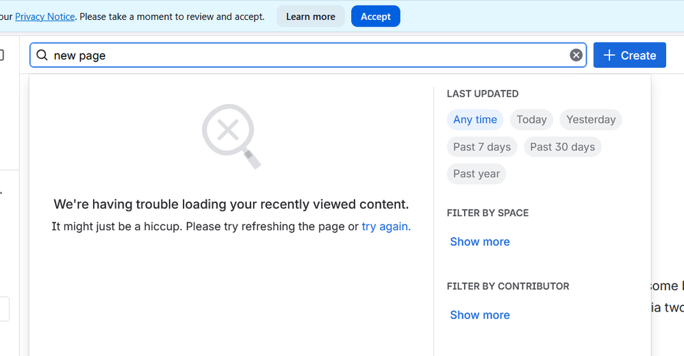

1. We set up our Confluence pages to have related pages using the 'Child pages' widget - enabling users to browse related guides.  However, when opening them within the portal, it takes the users to Confluence.  Is there anyway to avoid this without having to manually add the links in the portal? e.g. [domain]. atlassian.net/servicedesk/customer/article/158957569?source=topic
2. We are trying not to use Confluence because the search bar at the top doesn't work for our clients (who are not logged in).  Despite all our pages being able to be viewed via the link, for someone reason the main search returns this:
It works when our admins are logged in.
Is there anyway that users can search the Knowledge Base without needing a Confluence license?

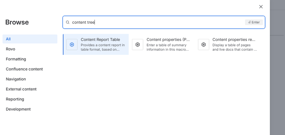

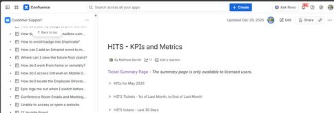

matthew barrett
March 16, 2026
Use the Content Tree instead of Child Pages widget. I did a quick test and that worked for me.
April 14, 2026
Thanks Matthew, sorry to be dumb but could you be more specific please? I search content tree and only got these three (see attached).  Looking for something dynamic that will change as we had pages - but doesn't send the user to Confluence Screenshot 2026-04-14 151933.png
