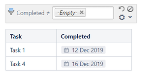

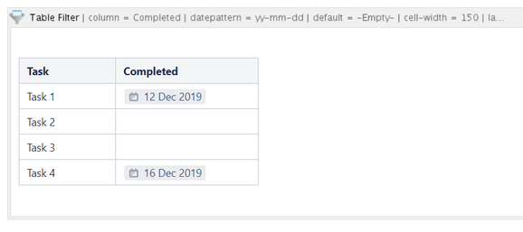

The first option is to filter table data. Place the Page Properties Report macro (or a manually created table or other macros generating tables) in the Table Filter macro body.
Filter all the not empty values in the Completed column.

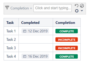

The second option is to add colorful statuses as indicators.

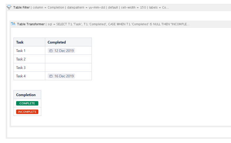

Place the Page Properties Report macro in the Table Transformer macro body. Add a small table with the Status macros.

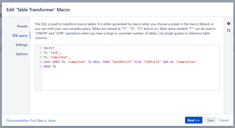

Use the following SQL query that meets your conditions:
SELECT
T1.'Task',
T1.'Completed',
CASE WHEN T1.'Completed' IS NULL THEN "INCOMPLETE" ELSE "COMPLETE" END AS 'Completion'
FROM T1
Get the following result:

Just curious on the use of the T1 table in the SQL query in the Table Transformer macro - how did that table name get assigned?
Natalie Paramonova [Stiltsoft]
December 19, 2019
Hi @tbellmr ,
T1, T2, T3, etc. means the ordinal number of the table inside the Table Transformer macro. The macro provides the ability to merge multiple tables that's why there may be multiple tables within the macro body and we name them by their ordinal number.
