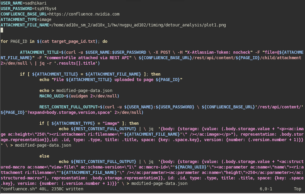

I am using the shell script provided in Using the Confluence REST API to upload an attachment to one or more pages | Confluence | Atlassian Documentation to attach images to a certain confluence page. However, when I run the entire script as a whole on my terminal, I am getting this error: cat: target_page_id.txt: No such file or directory.  I double checked the page id I provided and found it to be correct. What is this error due to? Please help me out

Thanks @Kishan Sharma  for your response! Yes now I created a text file and added the page ID to it and it seems to be reading it. However getting these errors for the following lines:
1) Line: ATTACHMENT_TITLE=$(curl -u $USER_NAME:$USER_PASSWORD \ -X POST \ -H "X-Atlassian-Token: nocheck" -F "file=@${ATTACHMENT_FILE_NAME}" -F "comment=File attached via REST API" \ ${CONFLUENCE_BASE_URL}/rest/api/content/${PAGE_ID}/child/attachment 2>/dev/null \ | jq -r '.results[].title')
Error: jq: command not found
2) if [ ${ATTACHMENT_TITLE} = ${ATTACHMENT_FILE_NAME} ]; then
Error: [: =: unary operator expected
This is the same code given on the page so not sure how these lines are erroring out?

November 3, 2021
Thanks kishan! All errors have disappeared now after I installed jq. But getting the message 'Failed to upload file to page <page ID>'. Is it to do with my credentials? I double checked my username, password, page ID and others. jq error.PNG
