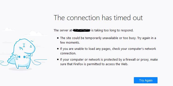

Hello Diego,
Thank you. I tried the steps you provided, the folders had root permissions and I however converted it to confluence user as suggested. I could not see the page loading even after these steps. Here is a screenshot of the UI . Please see as this used to work a few days back. It has not been up since the system was restarted. Let know. Capture.JPG
