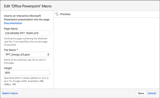

Hi,
I'm trying to display a pptx file in a confluence page. All the fields are properly filled. However, I get no response when I click preview or save. I tried reopen the page, uploading another pptx. None of these works...

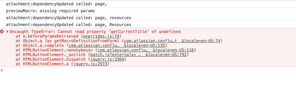

You can check your browser's Developer Console to be sure of the error messages that are being generated when you run into this issue.

The console error I'm getting is below:
I have the same issue, same error in console window.
