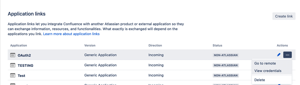

  1. Login into confluence on-prem server  and Go to image007.png > General Configuration > Application links.
  2. Select Create link.

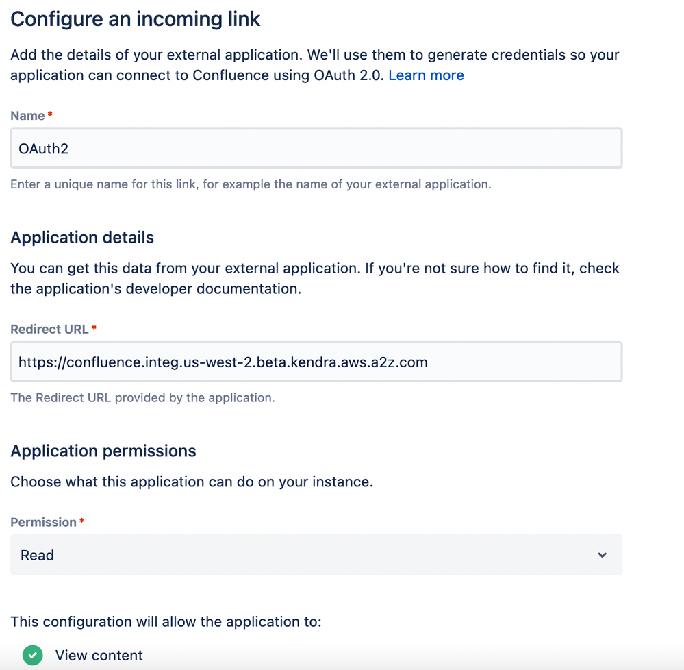

  3. Select External application, and then choose Incoming as the direction.

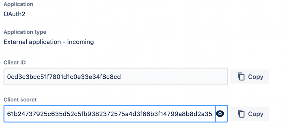

4. After this we’ll get client id and client secret of application link.

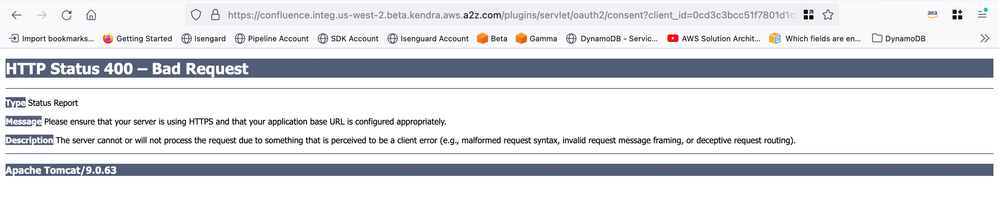

5. Request Authorization code by redirecting the user to the /rest/oauth2/latest/authorize page with the URL.
https://confluence.integ.us-west-2.beta.kendra.aws.a2z.com/plugins/servlet/oauth2/consent?client_id=0cd3c3bcc51f7801d1c0e33e34f8c8cd&redirect_uri=https://confluence.integ.us-west-2.beta.kendra.aws.a2z.com&response_type=code&scope=READ&code_challenge_method=plain&code_challenge=code_verifier
6. After hitting this URL we’re getting 400 Bad Request error on browser.
