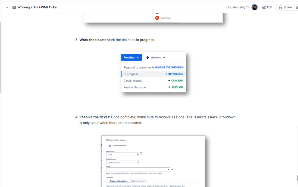

Hello - I would like to add spacing or snips between each line of my numbered lists. But when I do that, it restarts the following line back at 1.
If I add snips on the same line as the text, the snips can only be the size of the line  - making the snips smaller. It also makes it so the text, snip, text sandwich is SO close together with no line spacing between lines. This makes it hard to read.
Does anyone know if there is a fix for this?
I can't have the numbers restart at 1. And if I manually type in the correct line number (say it's 57.) then if I ever need to change something prior to line 57, all the numbers after that will be off (it does not update).
Please help!
I would like it to look like the attached photo. Notice how there is a lot of spacing between the snips and the numbered lines. The snips are on their own line and I am able to center them which I like. But in this photo example, I had to write each numbered line out manually and they do not update if I delete or add a line. Confluence example .png

For anyone who finds this post at a later date and wonder if I ever found a work-around, the answer is YES!
This is a small loophole. But it works for my needs. Paste all your photos on the same line as your text. it will lower the photo below the text automatically. Of course, the text and the photos still have no spacing at this point. Here comes the loophole: Right under the photo, click the empty space, it will allow you to type in a photo description. Enter any number or character. Change the color of said character to white. It will blend in with the page and keep one extra line of blank space between the bottom of the photo and the top of the next numbered item.
Tess Baird
December 31, 2025
Tess Baird
December 31, 2025
^ Look at those glorious spaces! Now I feel like the text and the pictures aren't SO crammed!

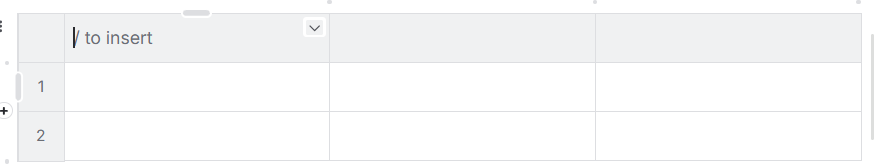

The linked ticket in her comment contains a workaround with tables, though I agree that it's far from ideal. Using soft returns (see @Kris Klima _K15t_ comment) is also a possible solution, but I find that inserting certain snippets always resets the numbering.

Have you tried using a table and using the table numbering? That seems to add some white space.
Thanks
Varsha
Tess Baird
December 15, 2025
Hello - No the information isn't really geared towards table format since I have a lot of pictures that are all different sizes.
