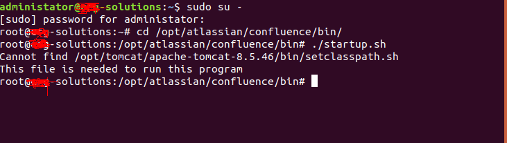

Hi Team,
I installed confluence and I'm not able to run the service. I'm getting this error after running startup.sh and also /var/atlassian/application-data/confluence is empty. Attached error screenshot. Please help me resolve this issue.Screenshot from 2020-08-07 16-23-41.png

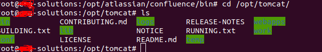

Hi @repi , Thanks for your response.
file does not exist.
