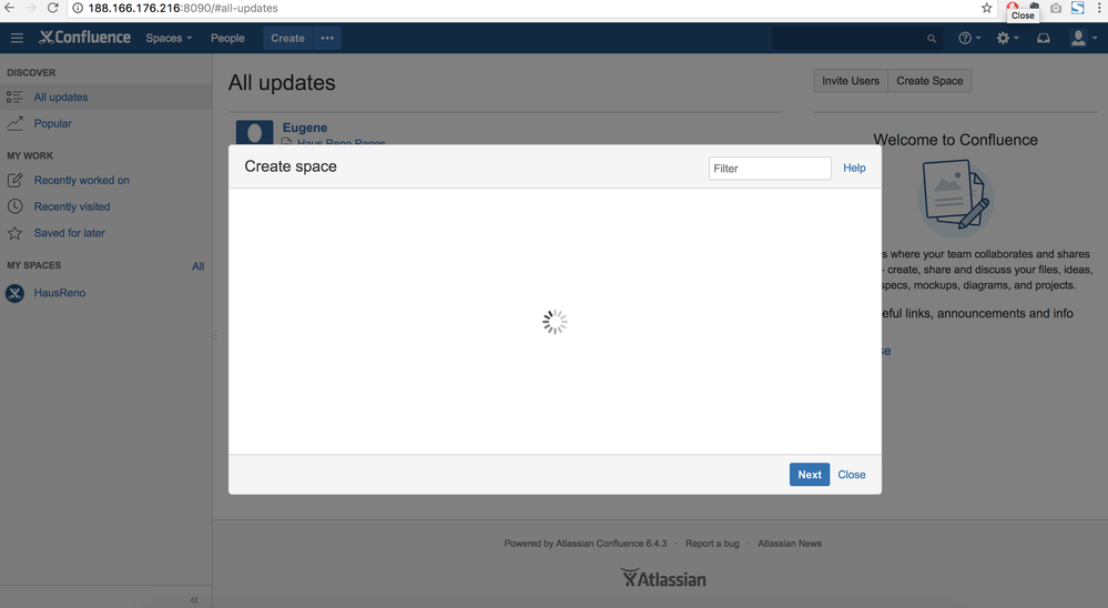

Not able to load create space or create button with ... it keeps loading
eugene tang
October 30, 2017
even i clicked on the ... button it shows the infinity loading
i have also checked in console.
http://188.166.176.216:8090/rest/create-dialog/1.0/blueprints/web-items?spaceKey=HAUS
it shows this error 500
{"errorCode":500,"errorType":"UNKNOWN","errorMessage":"bundle [com.atlassian.confluence.plugins.confluence-create-content-plugin]"}
what should i do next?
please advise
please advise

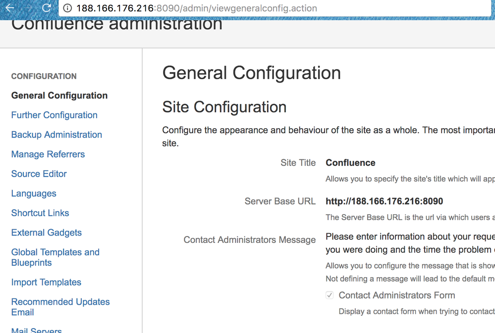

One reason for this is that If the base URL and the URL you are using to access Confluence is different you will face this issue.
eugene tang
October 30, 2017
im using both as an ip address

it also should be working because im using the same url
please check attached document
eugene tang
October 30, 2017
do let me know what do i miss
