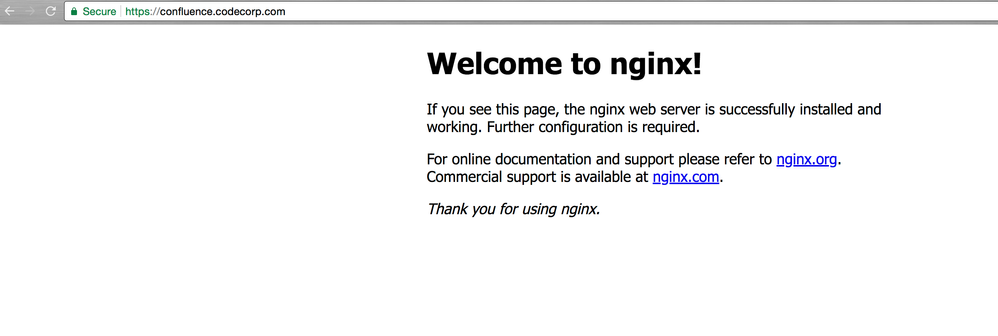

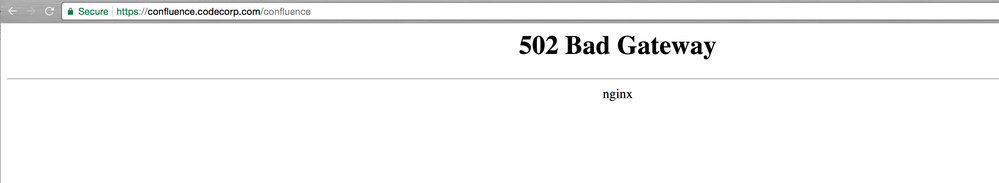

           I've tested a few things.
I can access
http://confluence.domain.com:8443
And it shows NGINX ( as shown in the screenshot attached)
However confluence isn't coming up, and confluence is now throwing errors. I believe possibly I have the server.xml misconfigured.
