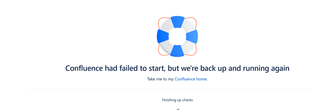

I am seeing this, I have not even tried to login to jira this is just confluenceScreenshot 2025-04-10 111137.png
Fabio Racobaldo _Catworkx_
April 10, 2025
please go on the server in your CONFLUENCE_HOME_FOLDER/log/atlassian-confluence.log and check the error message.

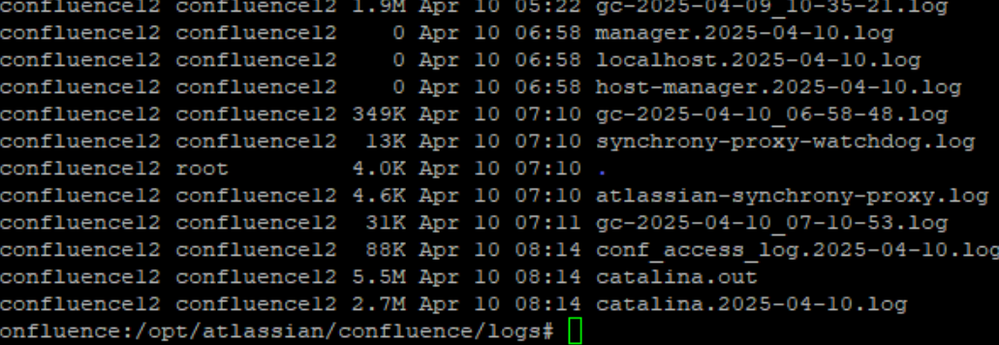

which file is it?
April 10, 2025
hey @Jesus Ramirez Castro , this is INST folder. Usually HOME folder is under /var/atlassian... but it depends how you setup instance. Go to Server info menu on the administration section to retrieve home folder location
