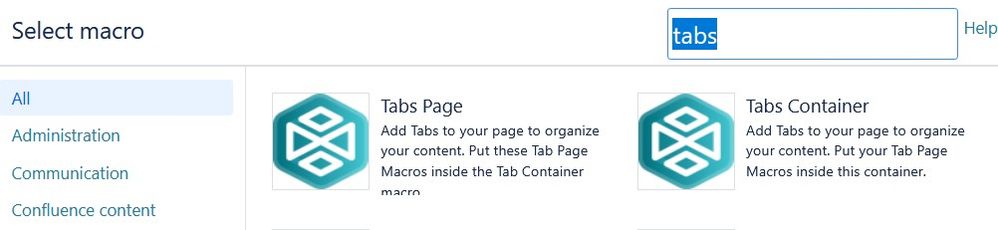

Tabs are not part of Confluence, so they come from an app. Which app is it? What is the name of the tabs in the macro browser? Can you provide a screenshot of the macro browser?

Balaji N
November 10, 2025
Hi,
Thanks for your response. I see the documentations of the tabs refer to the below link
https://docs.adaptavist.com/cfm4cs/latest/mosaic-macros/tabs
I found the following in Confluence Marketplace which I believe is used.
"Mosaic: Content Formatting Macros & Templates for Confluence"
Below is the name of tabs and tabs container in Macro.
Please let me know if any other details are required.
