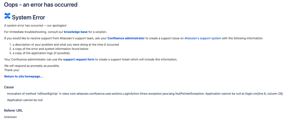

hello guys I really need your help on this :
 Invocation of method 'isShowSignUp' in class com.atlassian.confluence.user.actions.LoginAction
threw exception java.lang.NullPointerException: Application cannot be null at /login.vm[line 6, column 28]
it was not during a backup time or return system proc,
the confluence suddenly got the problem.
how can we solve it ?
My team would greatly appreciate your help  :) @Shannon S  @Brant Schroeder
Method I tried with my team so far:
my cwd_app_dir_mapping's index is correct  as 0,1 Asc
Also
I got unempty cwd_app_dir_mapping and
  • cwd_app_dir_group_mapping
  • cwd_app_dir_mapping
  • cwd_app_dir_operation

arthurnurislamov November 7, 2023
I tried using the suggested sql statement on my MS SQL server, and it says the statement is wrong. What am I doing wrong?
I tried the following statement:
UPDATE cwd_app_dir_mapping
SET LIST_INDEX=0
WHERE ID=<first_id>;
Rick Li November 7, 2023
Yes to use the statement the other answer give us, we should replace the
<first_id>
 with our own id ,
You can do following steps:
1
to connect to your database and look for the id by :
SELECT * FROM cwd_app_dir_mapping;
 and you will see the id (e.g. 1200000)
2
Then conduct the sql:
SET LIST_INDEX=0
WHERE ID=1200000;
3
And if you have more than one rows,
just repeat the update sql until you get  the list_index of the directories are in proper incremental order (i.e., 0, 1, 2, ...)
SET LIST_INDEX=0
WHERE ID= 1200000;
SET LIST_INDEX=1
WHERE ID=12000001;
SET LIST_INDEX=2
WHERE ID=12000002;
with
Perhaps, it's strange, but my  cwd_app_dir_mapping table is empty. It doesn't have any data.
I started getting this error only yesterday, just like you
In fact, all of the following tables
are empy
Rick Li November 8, 2023
It seems that yesterday during searching I have encountered the QA for empty tables, you can search for it. Mostly it happens during back up/return system for  your situation
arthurnurislamov November 8, 2023
Thank you!
I followed the instructions provided, I was able to create the admin/admin account.
But now all of the spaces are gone and I don't know how to recover them
Rick Li November 10, 2023
In this case , you can check your back-up
and found the last one with biggest usage (40kb,43kb,50M)
and restore the 50M back-up
I dont think you deleted them if you didnt run such command, so they must be here
