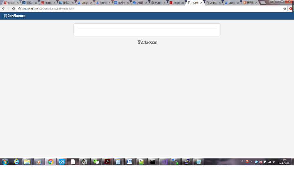

I started the linux installation , after mysql database is set up successfully, I am directed to a blank page, seems not successful. I have attached the screen as below, any thought?

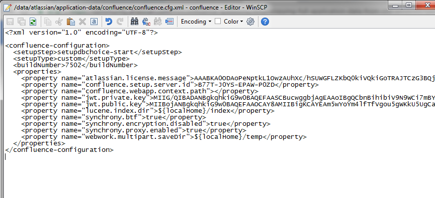

Untitled11.pngIt seems that the database setup information(connection string, username, pass) are not saved into the confluence.cfg.xml successfully. as below:

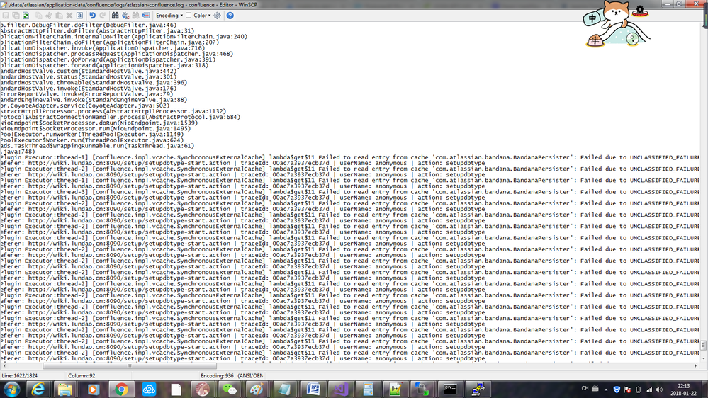

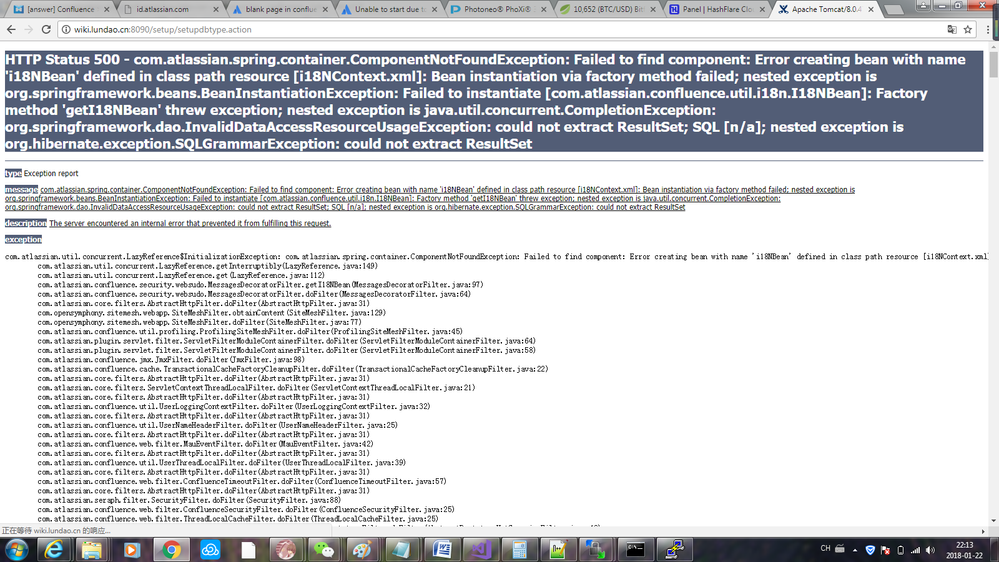

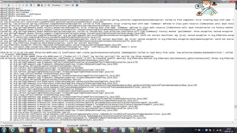

The MySQL server is available and I can ping it. I removed the log file: atlassian-confluence.log, and restarted the confluence service, and re-configure the database again, after connection string information is set and go to next step, it goes to the error page:
Here are the log screens:

Thanks a lot, @Shannon S. After I set up a DB user with complete permission, this issue has been fixed.
