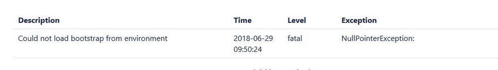

I see this....  2018-06-29 06:27:22 Commons Daemon procrun stdout initialized
2018-06-29 06:27:28,075 INFO [localhost-startStop-1] [com.atlassian.confluence.lifecycle] contextInitialized Starting Confluence 6.9.0 [build 7701 based on commit hash d7b403a44466e5e8970db7530201039d865e79e1] - synchrony version 2.1.0-master-ed94c233
2018-06-29 06:27:31,465 INFO [localhost-startStop-1] [atlassian.confluence.cluster.DefaultClusterConfigurationHelper] lambda$populateExistingClusterSetupConfig$1 Populating setup configuration if running with Cluster mode...
2018-06-29 06:27:31,512 ERROR [localhost-startStop-1] [atlassian.confluence.setup.ConfluenceConfigurationListener] contextInitialized An error was encountered while bootstrapping Confluence (see below):
null
java.lang.NullPointerException
at java.lang.Class.forName0(Native Method)
at java.lang.Class.forName(Class.java:264)
at com.atlassian.confluence.setup.DefaultBootstrapManager.isDriverPresent(DefaultBootstrapManager.java:794)
at com.atlassian.confluence.setup.DefaultBootstrapManager.checkRequiredDriverIsPresent(DefaultBootstrapManager.java:771)
at com.atlassian.confluence.setup.DefaultBootstrapManager.performPersistenceUpgrade(DefaultBootstrapManager.java:332)
at com.atlassian.config.bootstrap.DefaultAtlassianBootstrapManager.init(DefaultAtlassianBootstrapManager.java:81)
at com.atlassian.confluence.setup.DefaultBootstrapManager.init(DefaultBootstrapManager.java:179)
at com.atlassian.config.util.BootstrapUtils.init(BootstrapUtils.java:36)
at com.atlassian.confluence.setup.ConfluenceConfigurationListener.initialiseBootstrapContext(ConfluenceConfigurationListener.java:130)
at com.atlassian.confluence.setup.ConfluenceConfigurationListener.contextInitialized(ConfluenceConfigurationListener.java:64)
at org.apache.catalina.core.StandardContext.listenerStart(StandardContext.java:4884)
at org.apache.catalina.core.StandardContext.startInternal(StandardContext.java:5347)
at org.apache.catalina.util.LifecycleBase.start(LifecycleBase.java:145)
at org.apache.catalina.core.ContainerBase$StartChild.call(ContainerBase.java:1410)
at org.apache.catalina.core.ContainerBase$StartChild.call(ContainerBase.java:1400)
at java.util.concurrent.FutureTask.run(FutureTask.java:266)
at java.util.concurrent.ThreadPoolExecutor.runWorker(ThreadPoolExecutor.java:1149)
at java.util.concurrent.ThreadPoolExecutor$Worker.run(ThreadPoolExecutor.java:624)
at java.lang.Thread.run(Thread.java:748)
2018-06-29 06:27:31,543 WARN [localhost-startStop-1] [atlassian.confluence.plugin.PluginFrameworkContextListener] contextInitialized Not starting full plugin system due to upgrade or licensing errors
2018-06-29 06:27:32,293 INFO [localhost-startStop-1] [com.atlassian.confluence.lifecycle] init Confluence is ready to serve
Timothy
June 29, 2018
The driver error is probably related to a database driver issue.
You should review your xml configuration in your Confluence home directory.
Chuck Walters
June 29, 2018
