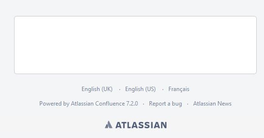

All I see on my screen after start-confluence.sh is run is a blank white rectangle.  I have no idea what is wrong, nor how to find it.Capture.JPG

Hello there,
Thank you for reporting this to us.
Is this a new installation? Have you already entered your database and license details?
Can you confirm that the screenshot is all you see yon your screen? Is the resolution not larger than this, or are you on a small screen?
Please also let us know your database version, server version, and the browser you are using. Have you been able to test this on other browsers?

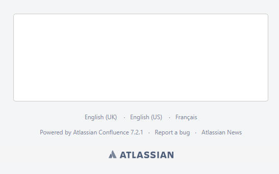

admin admin
February 10, 2020
admin admin
February 10, 2020
Hi Shannon,
First, I apologize, I have been looking everywhere to resolve this, and I haven't found anything thus far.  I do give my apologies for neglecting you while I've looked elsewhere though, as that certainly wasn't the wisest course.
As for your requests;
I have been unable to locate any errors in my logs, largely because the file is huge, and I have no way to determine which occurrences of 'error' are relevant.  I certainly don't mind passing my logs to you, though I will need a secure method to do so.
As for a screen capture of the page, it is attached.
Thanks for all you've done so far, and I hope we can resolve :-)confluence-login-lackthereof.png
