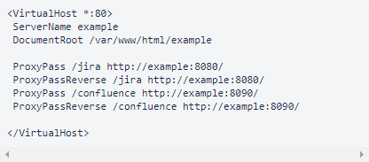

Sebastian Brookfield September 7, 2017
Hi Markus,
Which part of the config are you having issues with?
I'd expect you'd have something similar to the below in your Apache config.
Kind regards,
Seb
