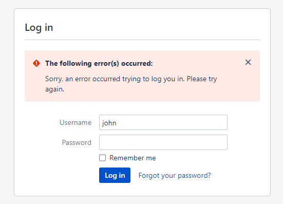

We have a working JIRA server with jira, bitbucket and Confluence. We move this server SQL DB to SQL Server Management studio v18.10 (SSMS). I can log into JIRA and bitbucket however I can not log into Confluence. When logging into Confluence I get the error "Sorry an error occurred trying to log you in. Please try again.
I have asked other users to log in. They get the same exact error.
Any help would be greatly apricated. I have been working on this for weeks.
