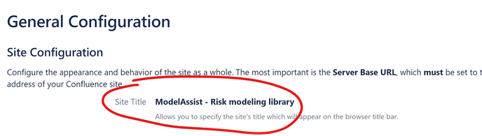

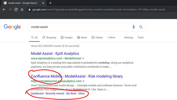

Do you also have insights on the other issue I described "when running a Google search for our space from a Desktop, "Confluence Mobile - " is appended to the name of our space in the search result, so I wonder if there is some other configuration that needs to be changed. " Please see the screenshots of a google search, and the Site Title under "General Configuration -> "Site configuration"

We actually want the side to be indexed by Google. The issue is that Google search is returning "Confluence Mobile -" added to the site name even though the title should be just "Model assist - risk modeling library". It's also adding the mobile site links at the bottom of the search as i highlighted in red, which don't work when browsing on a desktop. I will force a re-index and see if this is solved, but I suspect it's a bug.

Quick follow-up. The re-indexing fixed the issue, now the search result yields the proper name and desktop-only links so I didn't report this as a bug as I believe it's Google's policy now to crawl sites as mobile whenever that's available.
