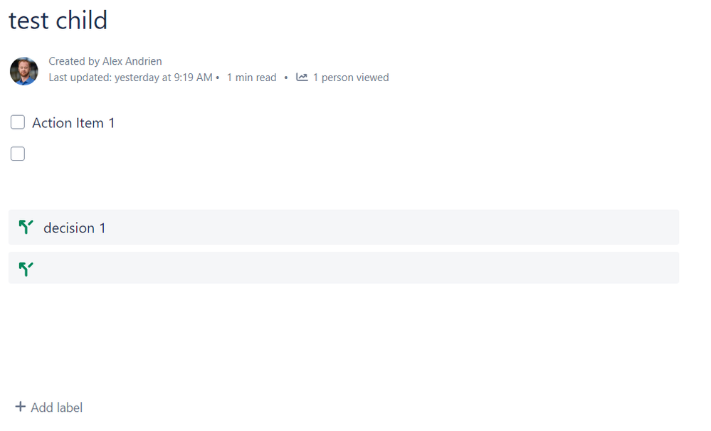

Below a test child page I created, having 1 action item and 1 decision.

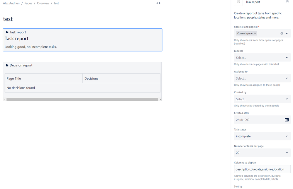

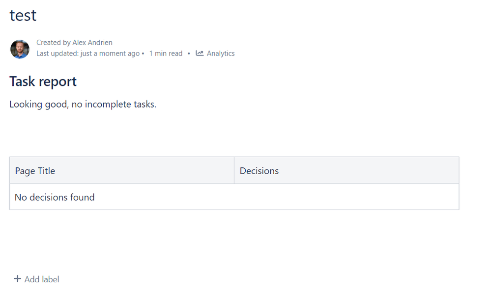

Then in the same space I create a page, containing the task report and decision report macros.
Here are the settings used for the Task Report. It says 'Current space', but why doesn't it show 'Action item 1'?

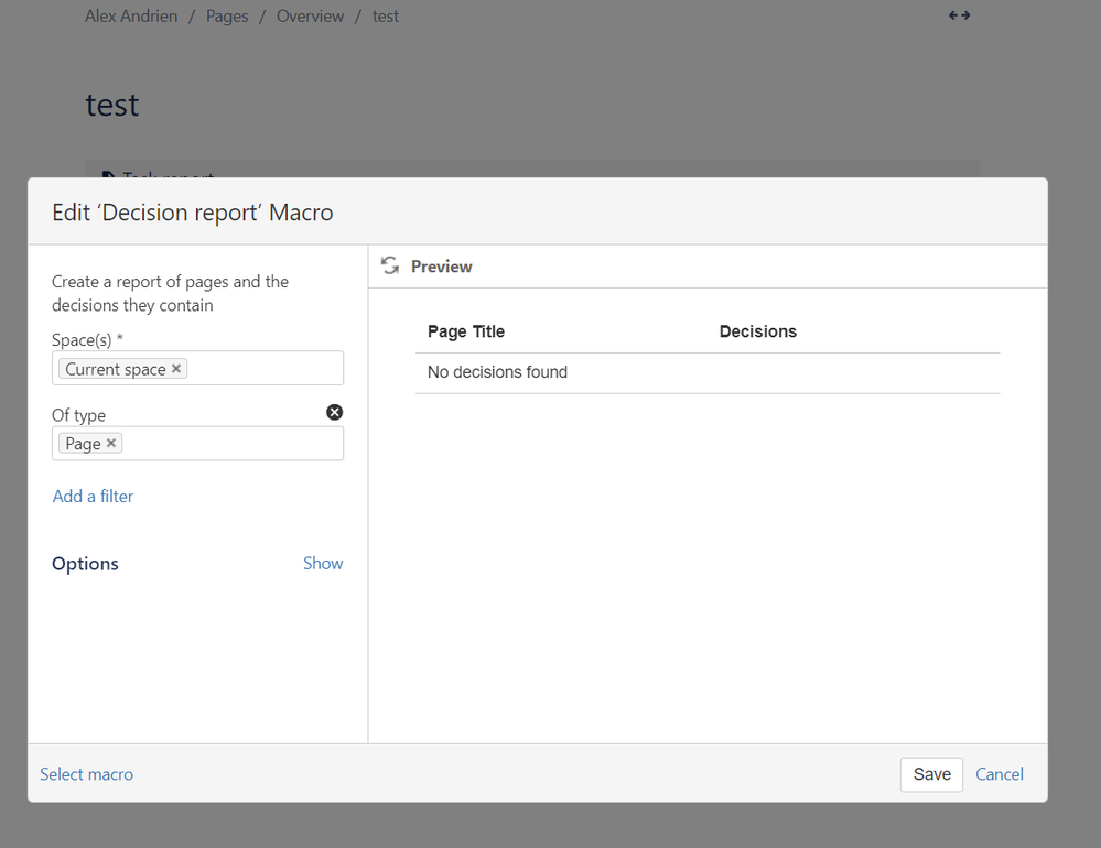

Here are the settings for the Decision Report:

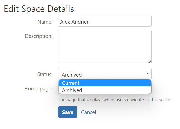

It turns out that my personal space's status was set to 'Archived'. After changing this to 'Current', the macros worked again and I can also see my personal space appearing in the suggestions, which wasn't the case before.
For future reference, you can edit this in the Space Details of the space and switch the status from Archived to Current, see below.
