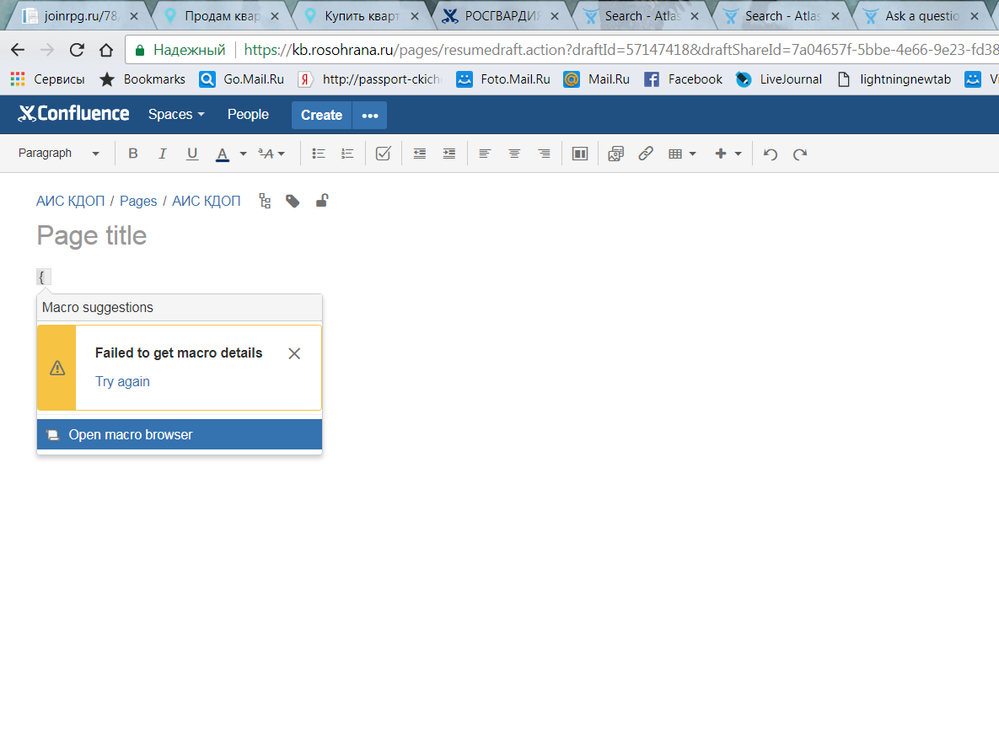

Hello everyone.
We've just moved from cloud to server, and , after that, macros browser stopped working, it renders the
I wonderm if that has to do our proxies...
I would be grateful for any advice!
WE use macros all the time, and it doesn't make sense to use conf without them.

It could be proxies or addressing.
Two debugging things to try first:
  • Check the base url is correct, then go on to the server and use "sslpoke" to check that Confluence can resolve it's own url and connect to it.
  • Check the logs at the time the macro error appears - what do they say?

Hello, Nic.
Thanks for the advice. But it turned out in the end, I needed to turn off Gadget Plugins...
Nic Brough -Adaptavist-
July 31, 2017
Hmm.  Ok, do you mean you had an add-on with a broken gadget that was stopping the others from appearing?
