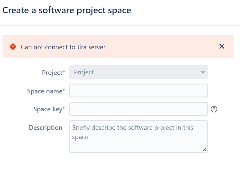

After applying the security update for Confluence Data Center, we can not make software spaces anymore as the link to the jira server seems lost.
2022-06-04 10_56_44-Application links - Confluence and 5 more pages - Work - Microsoft​ Edge.png

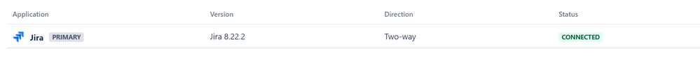

However, when checking application links, everything seems fine
2022-06-04 10_56_51-Application links - Confluence and 5 more pages - Work - Microsoft​ Edge.png
