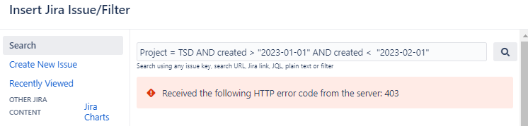

I have a test page where I have a issue filter macro in confluence.
In that filter I enter the following JQL querry
Project = TSD AND created > "2023-01-01" AND created < "2023-02-01"
By doing this I get the following error
If I remove the filter part of date range and leave only the project type, the issue filter work ok and no error.
The same filter as Project = TSD AND created > "2023-01-01" AND created < "2023-02-01" works perfectly well on Jira Search issue.
Any idea what is going on ? any of you face same issue
Why it works in jira and same filter not working ok in confluence
Please not that I have full access right and permission on this project in Jira
Thanks for help

Hello @Charlie Misonne we are using Jira 9.4.2 and confluence 7.20.2 both Data Center

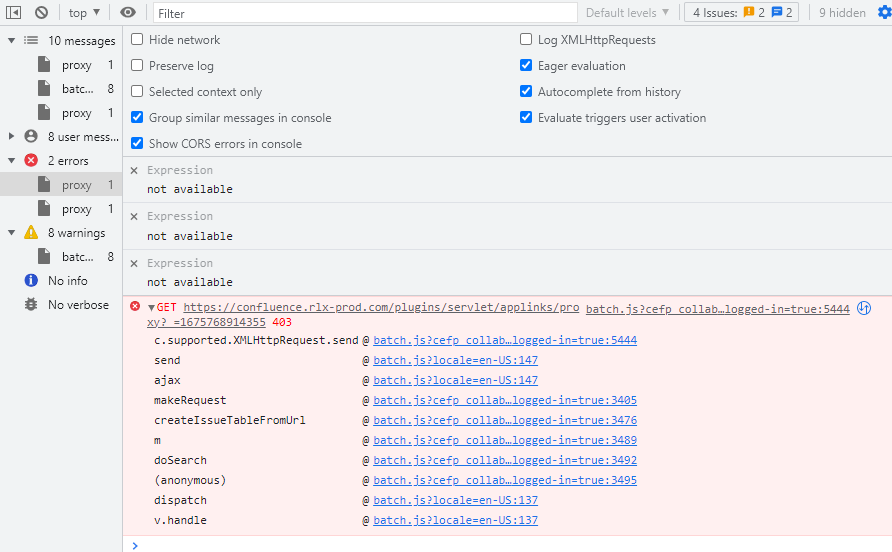

Yes I have access to logs but could not see any error when issue is reproduced in confluence
I have notice that If I keep only the first date filter in the JQL as below :
Project = TSD AND created > "2023-01-01" where created is a system field, then it works and I did not get the error.
I get error when I try to specify a date range
In debug window I only get the following
