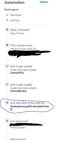

Im trying to form an email report using {{LookupIssues}}
I get a result for lookup Issues and I can confirm that the description text is the same. Though I cant seem to pass the description text along with format (as html). It seems to come through as Wiki markup.
PROBLEM:   I am trying to pass *{{lookupIssues.get(0).description.html}}* in order to retain the format present in the issue when viewed on Jira cloud. Though when I place this in the email body, It retains the wiki markup and it wont convert to HTML.
As an Automator, I would like my Issue format to carry through as HTML, so that Outlook can read the code and retain my formatting.

I found that If I pass
{{lookupIssues.get(0).description.text}}
 I can put the HTML in the description field and it passes through the automation and  renders properly
