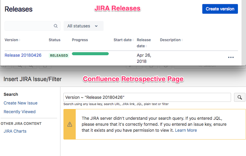

I just tried to do this and it isn't working for me. Here is a screenshot of my JIRA releases with the test release today. Then the "Insert JIRA Issue/Filter" form where I am trying to insert the table from. But I get the warning shown.
Not sure how I would do this by a custom field ID, it would be easiest to do it on the field name.

I wonder if there is an issue with the JQL through Confluence. Can you try and do the search inside of JIRA and save it as a filter to see if that works? Then you can pull in the filter through Confluence rather than using the JQL.

Ahh! I figured it out. This is the query I am looking for:
fixVersion="Release 20180426"
Thanks Ryan, I appreciate your help!
