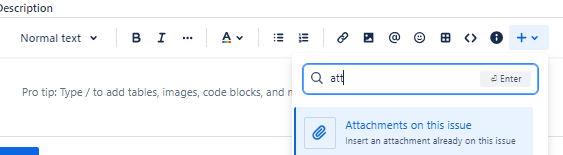

You can attach the documents to any issue type in jira then you can go to Description.
Press + select attachments on this issue and you will find the recent attachments.  Click the attachment you want to save in description.

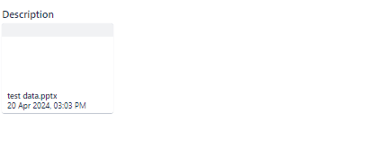

you will see the attachment in the description and then save it.
Cap 2.PNGcreate a dashboard and any filter drop down select the Description and will show you only the attachment file name.

Go to any issue type and add the attachments.  Later save the same in description field which is shown above by clicking + add the attachments on this issue.  Create the dashboard, add the filters, select the description field in drop down.

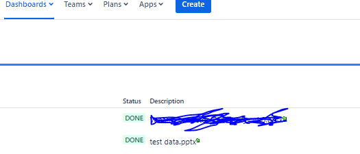

Jira Dashboard ; you can see the attachment in description and when you click the file name it will download.

You can finally see the attachments in JIRA Dashboard.
