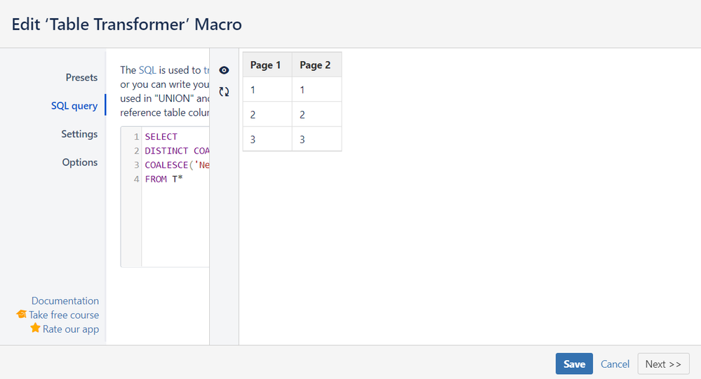

I can also suggest another query for your case:
SELECT
DISTINCT COALESCE('New 1', 'Text 1') AS 'Page 1',
COALESCE('New 2', 'Text 2') AS 'Page 2'
FROM T*

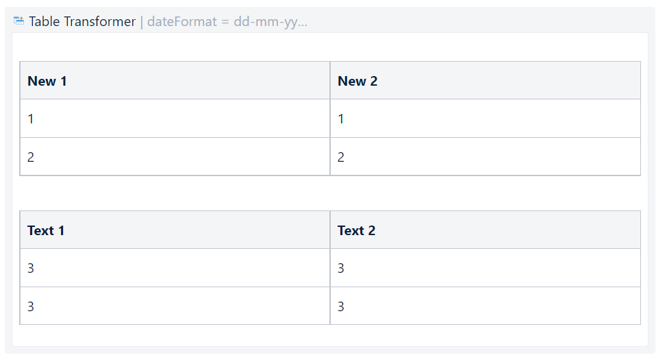

Here I merge two tables: with headers “New 1”, “New 2” and “Text 1”, “Text 2”.
The COALESCE function is used to list all the possible variations of the column names that you want to rename in a specific way.
So, your original SQL query will be much shorter and easier to read.
