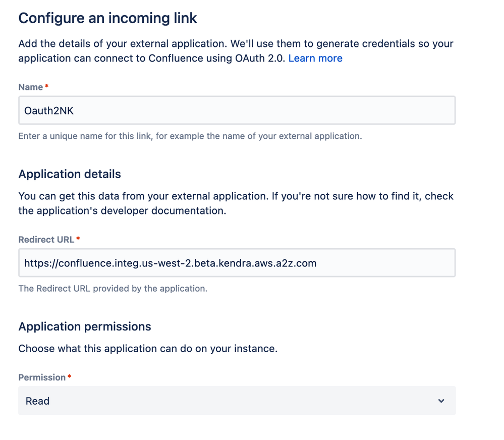

To create an incoming link.
  1. Login into confluence on-prem server  and Go to image007.png  > General Configuration > Application links.
  2. Select Create link.
  3. Select External application, and then choose Incoming as the direction

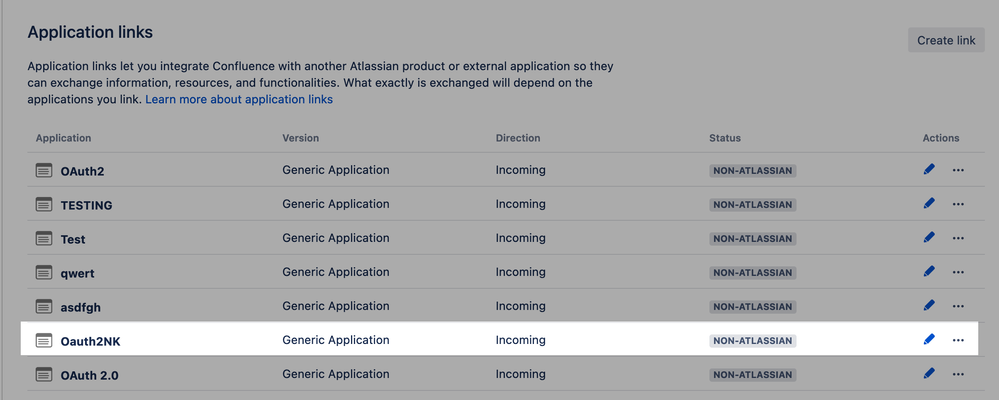

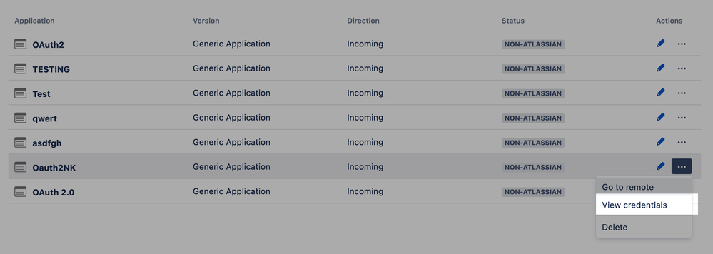

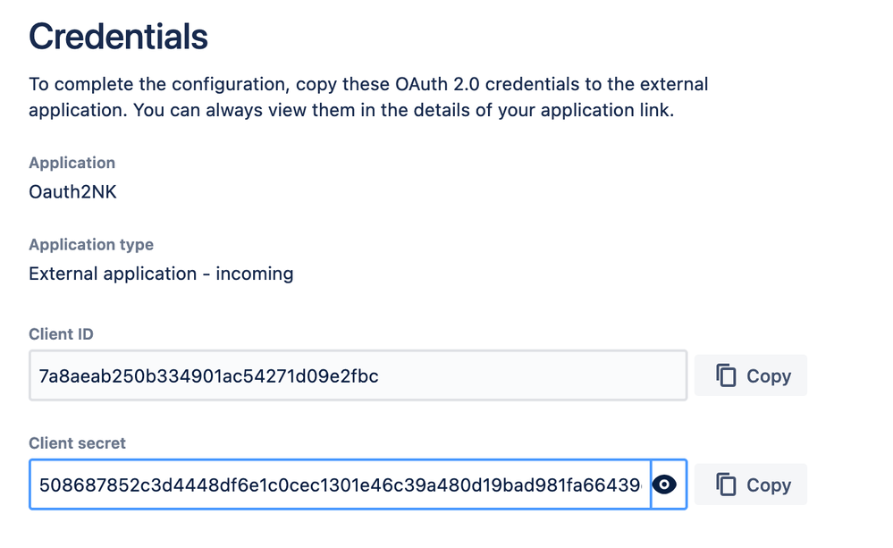

4. After this we’ll get client id and client secret of application link.

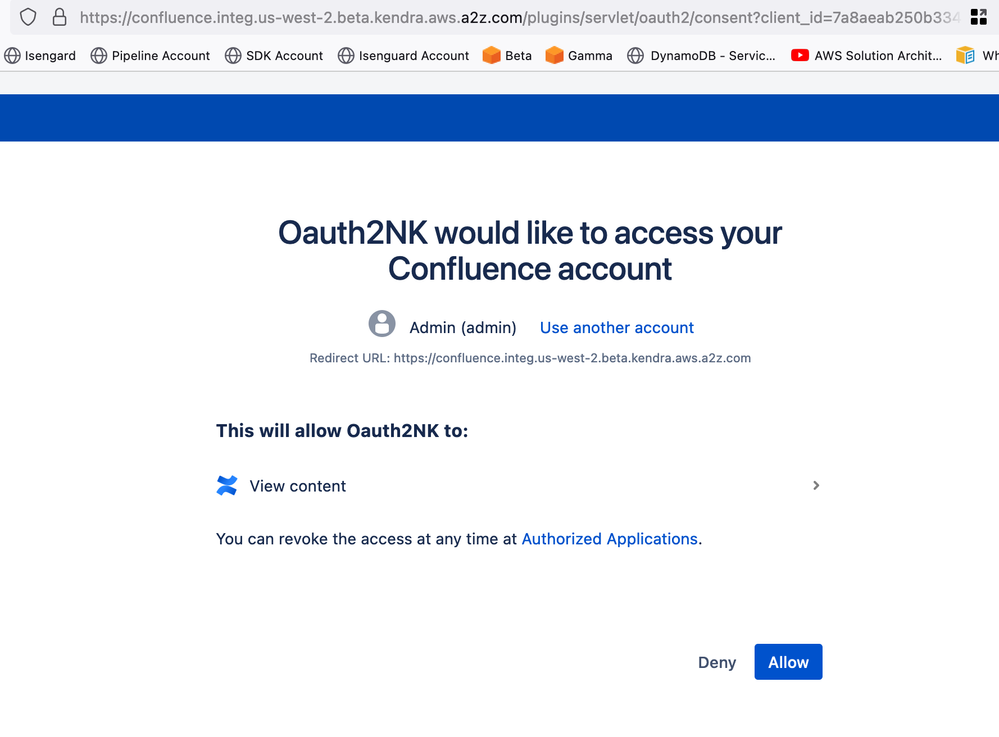

5. Request Authorization code by redirecting the user to the /rest/oauth2/latest/authorize page with the URL.
https://confluence.integ.us-west-2.beta.kendra.aws.a2z.com/plugins/servlet/oauth2/consent?client_id=7a8aeab250b334901ac54271d09e2fbc&redirect_uri=https://confluence.integ.us-west-2.beta.kendra.aws.a2z.com&response_type=code&scope=READ&code_challenge_method=plain&code_challenge=code_verifier

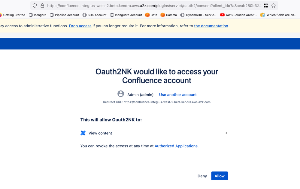

 6. This is the consent screen that asks the user to approve the application’s request to access their account with the scopes specified in scope. The user is then redirected to the URL specified in redirect_uri. The redirect includes the authorization code

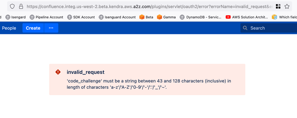

7. Clicking on Allow button results in the below error message and we don't get the authorization code.
What should we put in the code_challenge_method and code_challenge query parameters in Step 5 URL? Currently, we use the code_challenge_method=plain&code_challenge=code_verifier parameters and when we check the logs in <confluence_installation_directory>/logs/catalina.log file we didn't find any error in that so where we need to check the confluence logs for the above error.

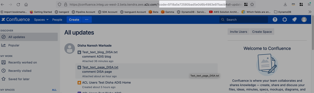

9. When click on Allow button we get authorization code.
Authorization Code : 5f18a5e72580bad5e0d6b4983e97bacb

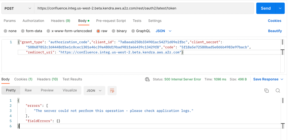

10. With the authorization code returned from the previous request, we can request an access_token with postman and in this step we get another error like
"The server could not perform this operation - please check application logs."
when we check the logs in <confluence_installation_directory>/logs/catalina.log file we didn't find any error in that so where we need to check the confluence logs for the error.
