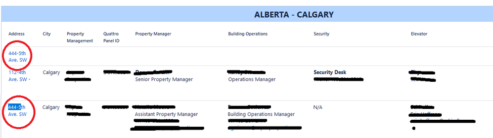

I use page breaks on my confluence pages so I need to use multiple page properties macros. I noticed when I use 6x page properties macros on one page they pull into a report fine, as soon as I add the 7th it breaks. Is this something that can be fixed?

When you say that it breaks what does that mean?  Can you share a screenshot?
I have a server version and have not run into any issue with the number of macos on a page.  I am wondering if you are using macros that are larger in size and taxing your server's resources. You might need to add additional memory.  If you share the specific macros I could try and recreate the issue.   Also have you checked the logs?

Here are some screen shots.
On the page for 444 5th Ave, I added the 7th property macro and then in my page properties report it showed up twice (as circled in red)- cnce populating the fields in the report, and the second time with blanks.

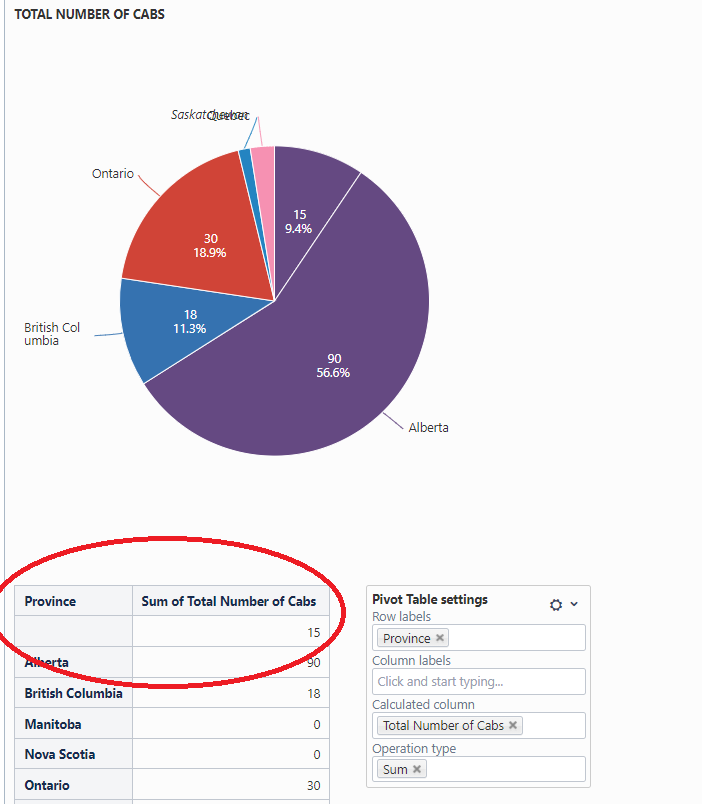

It also appeared in my Chart from Table pie chart as a blank as well. As soon as I remove the 7th page property, all the reports go back to normal.
