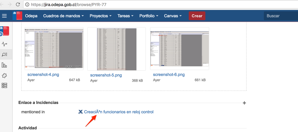

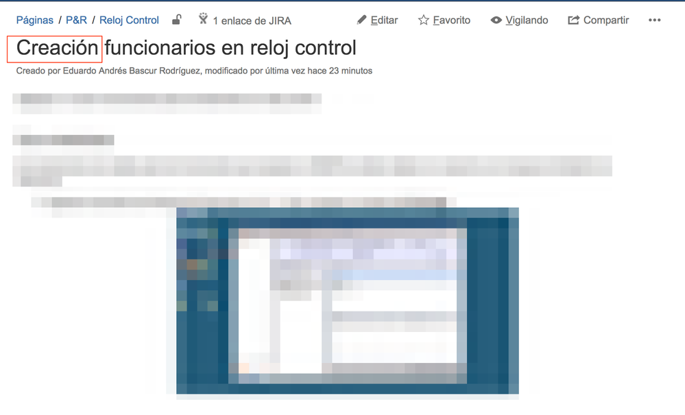

I created a section on Confluence, and added an issue link with jira core, but when I add the issue link on my jira Core the name of my article does not see accents. The text do not readable. How to I resolve this problem?
The name of the article is "Creación funcionarios en reloj control", the view name on jira core "Creación funcionarios en reloj control"
Jira Core issue Link with confluence

Confluence view.

Since this text looks correct in Confluence, but not in Jira I think the problem is actually with the encoding Jira is using.   I would recommend trying to follow the steps in JIRA Application internationalisation and encoding troubleshooting
We typically recommend setting all aspects of Jira to use UTF-8, however I have noticed that out of the box, many installations of Jira are not necessarily using this, either because of system environmental variables or sometimes the system just defaults to use another encoding method such as ANSI.X3 or cp1251.
I would recommend trying to start Jira as that guide recommends with:

I have reviewed your comment and I did what you told me. The answer is correct.
I set the variable -Dfile.encoding=utf-8 and -Dsun.jnu.encoding=UTF-8 on file setenv.bat of my jira, and problem was resolved.
set JVM_SUPPORT_RECOMMENDED_ARGS= -Dfile.encoding=utf-8 -Dsun.jnu.encoding=UTF-8
The configuration is done with Jira stopped, then I rebooted the instance once upon the change was made.
