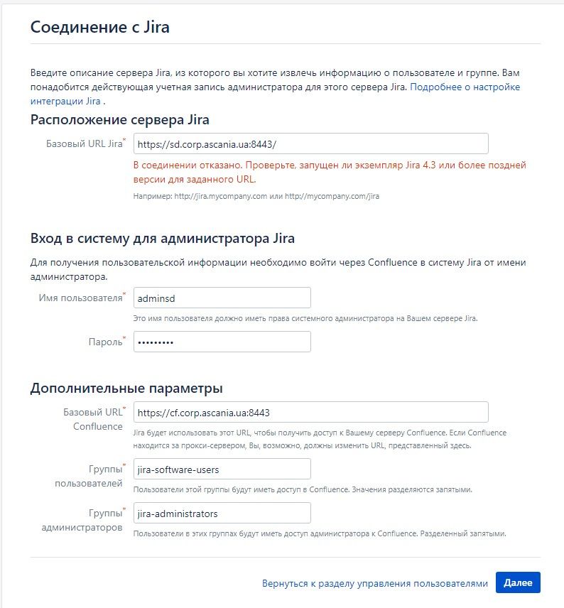

I am trying to integrate JIRA and Confluence together. They both run over port 8443 on different servers.
https://sd.corp.ascania.ua:8443
https://cf.corp.ascania.ua:8443
I added certs SD and CF to sd.server And added certs SD and CF to cf.server. So when I use wget https://sd.corp.ascania.ua:8443 on CF.server it return correct index.html, and from SD.server wget https://cf.corp.ascania.ua:8443 return correct index.html.
When wizard setup Confluence (after clear install) connect to Jira I have error: connection refused...
