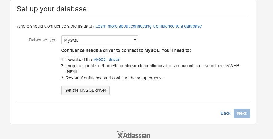

Hi,
I'm sure this is an easy solution, but I'm stuck. I'm trying to install Confluence on a Linux server, with MySQL. I have installed Confluence and when I get to the installation section to select DB, I select MySQL and the NEXT is grayed out. I thought I uploaded the extracted .jar MySQL file to the right location but I can't get past the MySQL screen. I've stopped and restarted Confluence, a few times with no luck. Is it possible I'm uploading the MySQL connector to the wrong location?
Can anyone tell me where the installation is if my system is something like this: /home/ellumigl/xxxxxxx/atlassian-confluence-6.6.1-x64.bin ?

Hi Justin,
I've recorded a video so you can see where to put the MySQL Driver.
In the beginning of my video, you'll see a lot of different folders with the Confluence versions that I have installed on my system.
Watch once I go into the folder for the 6.6.0 version and I will show you where to put it:
Steps:
  1. Stop Confluence.
  2. Find the Confluence Installation Directory. This is where you extracted the Confluence installation file. It is different than Confluence home directory. See Confluence Home and other important directories for more information.
  3. Once inside the installation directory, you should see folders like in the 2nd screen, such as bin, conf, confluence, lib, etc.
  4. Go into the folder called confluence, from there to WEB-INF, and then from there, into the folder called lib. You can watch the video for my example.
  5. Drop the MySQL driver into the lib folder. My video above will also show you what other files are already there. It should only contain other .jar files.
  6. Once you've added the driver, you can then start Confluence up again.
Can you give that a try, watch my video if you're unsure, and let me know if you have any trouble?

Shannon,
I feel like I'm taking crazy pills. I think I've tried doing about 8 different setups and each time fails. I just can't get past the database setup page.  When I try to select MySQL, the next button is grayed out. I've checked the location of the file and it's where it is supposed to be. Is it possible that I'm supposed to rename the mysql driver so confluence recognizes it?

Hi Justin,
You should leave the name as is.
Just to verify:
  1. Navigate to this driver download page
  2. Download either the TAR or ZIP file, and extract it.
  3. This will create a directory called mysql-connector-java-5.1.45. Navigate into this directory.
  4. There, you will find a file called mysql-connector-java-5.1.45-bin.jar. I recommend leaving the file name as it is.
  5. Drag this file into the location I let you know about earlier.
If you still have issues, can you let me know what permissions the user running Confluence has for that file? Your server admin may need to check for you. It should have read permissions at least.

Hi Justin,
The problem is, you're likely not using the root user to run Confluence.
If you used the .bin file to install Confluence, then each time it is started, it switches to the confluence account on your operating system.
This is the account that probably does not have access to the .jar file.
You can check this by requesting the output of the start-confluence command.
In order to resolve that, you can either change the <confluence-install>/bin/user.sh script to use root instead of the confluence user, or change the permissions to confluence user for all files and folders.
