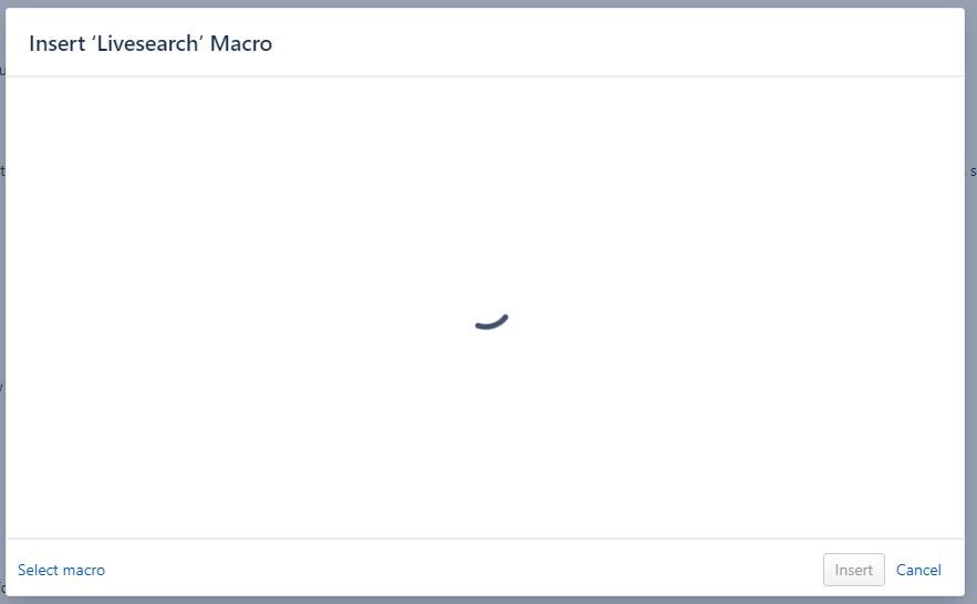

Dear All, I am using Confluence version 7.1.0 and have noticed that Liveseach macro stopped working in recent version. Does any one have any idea whether its a bug or configuration issue ?
nl.avisi.confluence.plugins.numberedheadings:nh-macro-browser-fields.js:5 Uncaught TypeError: AJS.clone is not a function
at Object.AJS.MacroBrowser.ParameterFields.enum (nl.avisi.confluence.plugins.numberedheadings:nh-macro-browser-fields.js:5)
at v (com.atlassian.confluence.plugins.confluence-macro-browser:macro-browser-js.js?locale=en-GB:75)
at Object.<anonymous> (com.atlassian.confluence.plugins.confluence-macro-browser:macro-browser-js.js?locale=en-GB:80)
at Function.each (batch.js:33)
at c.fn.init.each (batch.js:29)
at Object.loadMacroInBrowser (com.atlassian.confluence.plugins.confluence-macro-browser:macro-browser-js.js?locale=en-GB:80)
at Object.successCallback [as success] (com.atlassian.confluence.plugins.confluence-macro-browser:macro-browser-js.js?locale=en-GB:125)
at c (batch.js:44)
at Object.fireWith [as resolveWith] (batch.js:44)
at u (batch.js:44)

Shannon I have attached a screen-shot below from which you can see that it stuck in an infinitive loading loop forever.
I have checked the console log and above error is displayed.

Thank you for the screenshot.
