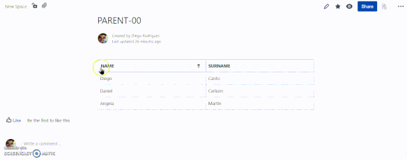

Hello, @[deleted] !
As I understand, placing and visualizing inline comments does not behave as expected when used within table headers.
With the above in mind, I tried to replicate the issue locally. Since it is not quite clear which platform or editor that you are using, I tried it in Both Confluence Cloud and Confluence Server.
In Confluence Cloud, I tried with both the Old Editor (tinyMCE) and with the New Editor (Fabric). In the old editor, I was unable to highlight the header text and when I clicked the header, the table was sorted.
In Confluence Server I was also unable to select the header text and ended up sorting the table. With both results, I have raised these reports:
However, I was able to successfully perform this (select text and place inline comment) in Confluence Cloud with our new editor. Here is what I see:
