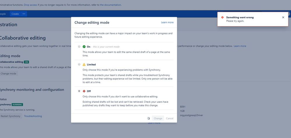

Its not working still.
Even I cant turn of collaborative editing

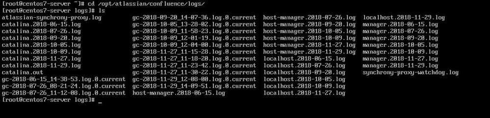

And which logs you are after

Those are server logs, tail the application logs from your confluence-home dir (application data/logs) and check what's in there.
Also, make sure that you have a dedicated user to run confluence and that all files are owned by it. Run "ls -la" in both confluence-home & confluence-install directories and if they are owned by root or else, make sure to use chown -R to change ownership to confluence user.
