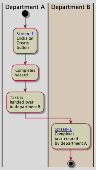

Vikaash Mahabir
February 14, 2020
Hi @Kirstin Seidel-Gebert , I didn't receive a notification, hence the tardy response... To answer your question: no, unfortunately I have not. You could try the following code to see if it works for you. Mind you, we're using Confluence Cloud.
@startuml
|Department A|
start
:[[http://plantuml.com/start Screen-1]]
Clicks on
button;
:Completes
wizard;
:Task is
handed over
to department B;
|#AntiqueWhite|Department B|
Completes
task created
by department A;
stop
@enduml
This should result in:
 2020-02-22 19_00_02-Bewerken - Redesign proces seizoensomcodering of wijziging van eigendomsmodel - .png
(now the correct diagram that goes with the code ;) )
