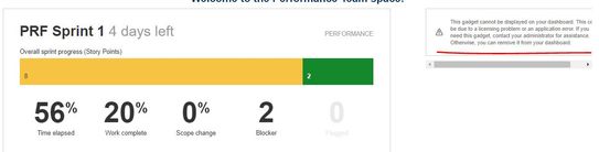

@Shannon S Oops! it started to fail again. It loaded the first time but then started to fail by one or another.
Here's a screenshot:

I see that Janet was able to confirm that it is indeed the bug I mentioned, and had increased priority on it.
I see that the error in your screenshot is indeed the same error as Janet mentioned.
I've checked the bug and I'm happy to say the issue should have been resolved yesterday, since a fix was pushed out.
Could you please confirm if you're still having the problem?
