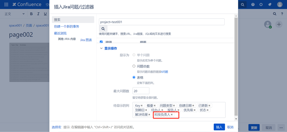

In conference, when using JIRA macro, an error is reported: there is a problem in rendering section: {0}
op_yanfz
July 20, 2022
hi.
I encountered the same problem, and found that the encoding format of JIRA and Confluence system is not consistent. When I changed the encoding format of Confluence and JIRA to UTF8, the problem is solved, you can try it
Nic Brough -Adaptavist-
May 7, 2021
Could you show us the configuration of your macro?
zhoufangdong
May 7, 2021
OK, the configuration is shown in the figure below. The red box is a user-defined field. If it is not added, no error will be reported.1620442503(1).png1620442557(1).png
