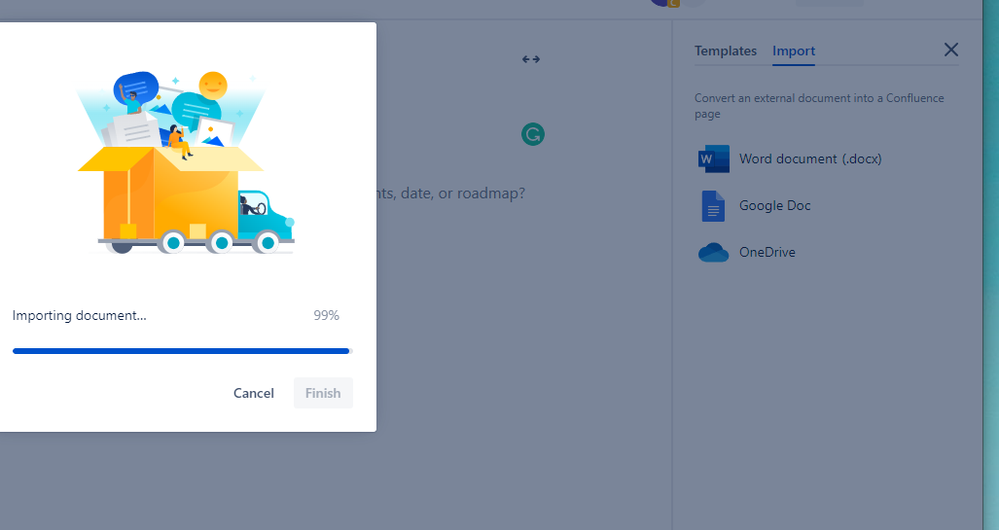

I have been able to import about 40 Word Documents (DOCX) into Confluence but now I consistently fail at 99%.
I am now presented with this message when I click the Word document (.docx) button:

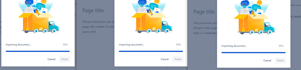

The the progress bar appears...looks like it is moving at a good pace but then slows down at around 70% or so and never gets to 100%.

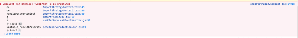

I am also facing the same issue (tested Firefox and Chrome latest versions) - errors on Chrome

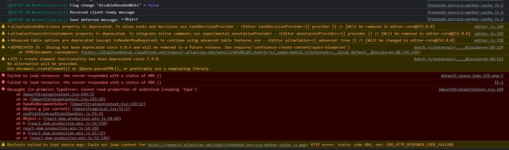

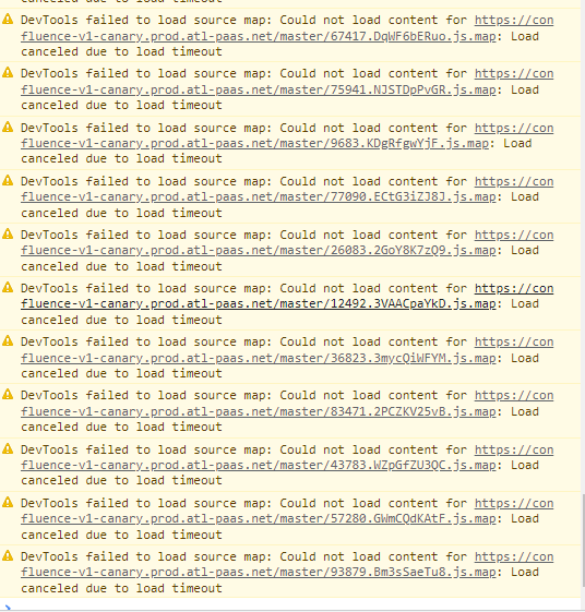

I'm getting the same issue in Chrome, Firefox, and MS Edge.  It happens whether I try to upload my document, import via Google, or via OneDrive. I tried an alternative Word doc I produced and got the same result.
I did get some errors, yes. I attached screengrabs from my Chrome and FF browsers.

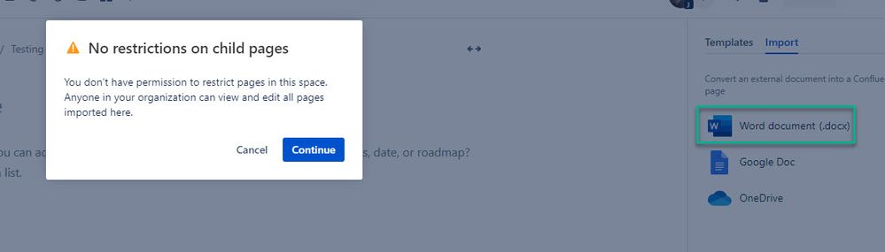

When you import, are you splitting on headings? If so, are you trying to create a page in space or page tree with restrictions? In other words, when you import, you create pages. Those pages inherit permissions from the parent page. If you do not have rights to restrict pages, then you will hit this issue on import.
A quick test is to ask an admin to perform the same import for you to see if they have the same issue.
