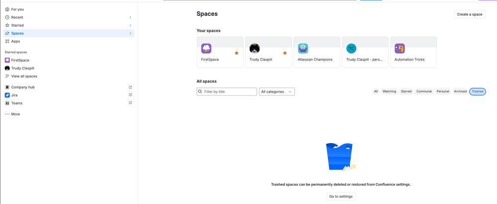

When you elect to delete a space it is moved to the Trash folder.
You need to empty the Trash folder to completely delete a space key from the instance.

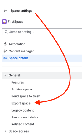

Did you export a single space from Space Settings for that space?

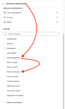

Or did you use the Backup Manager from Confluence Administration?
