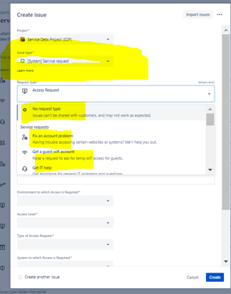

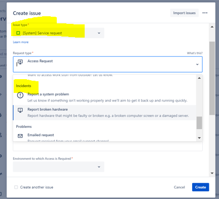

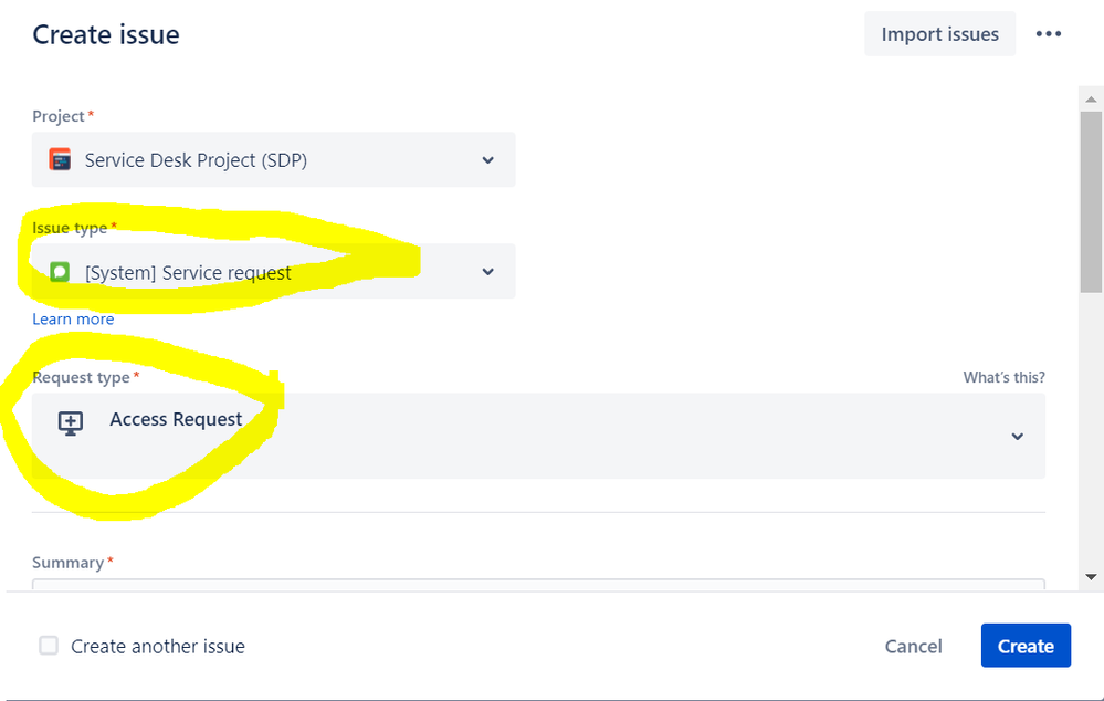

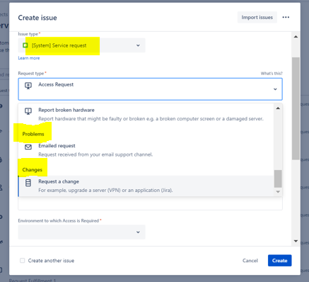

If i select Issue Type as Service request then i want to see only request types for Service request
Sreenadh
October 28, 2022
Hi,
If i select Issue Type as Service request then i want to see only request types for Service request.
for example:
If i select Issue Type : Service request
then i want to see Access request and Request Fulfillment.
i don't want to see all the things which are for Incident and problem and Change
Please find the attached screenshots for your reference.

A request type is bound (associated) with a specific issue type. When you select an issue type, then the first available request type using that issue type is selected. And from below you can see the rest of the request types. If you select a different request type, then the issue type will change (if that request type is using a different request type).
Currently, I don't think that there is a way to restrict what is going to be visible there.

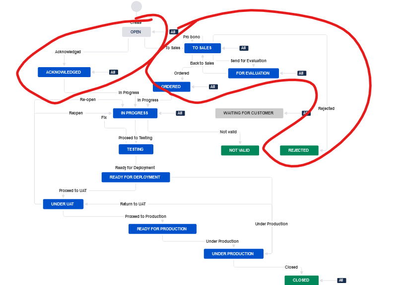

Issue types are associated with only one workflow. Therefore, you can't have the service request type following two different workflows per se, depending on what the request type will be. What you could do though is to create a single workflow, while separating the two request types with transition conditions inside this workflow.
E.g. one of my clients wanted for different two request types, one share workflow:
In the above image, the left side was for bugs, whereas the right side was for sales. Both of these request types, after a point were following the same workflow (In progress, Testing, Etc)
