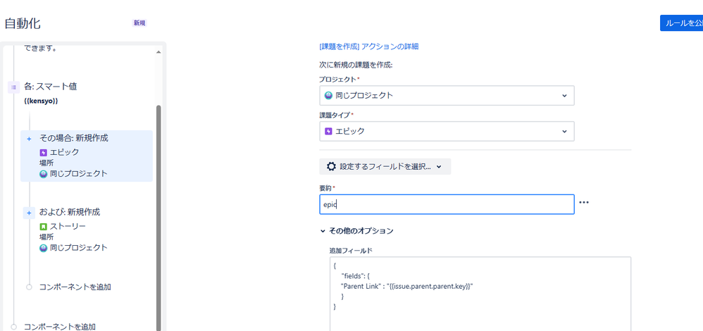

koutarou ishibashi
October 29, 2023

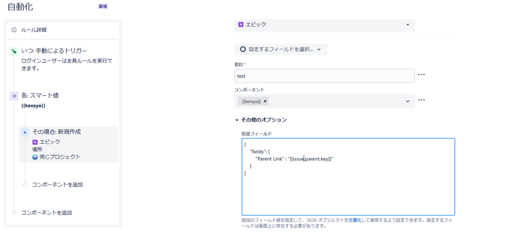

I'm setting up a custom hierarchy.
There are three hierarchy levels: 3, 2, and 1
The parent of 1 is 2 and the parent of 2 is 3

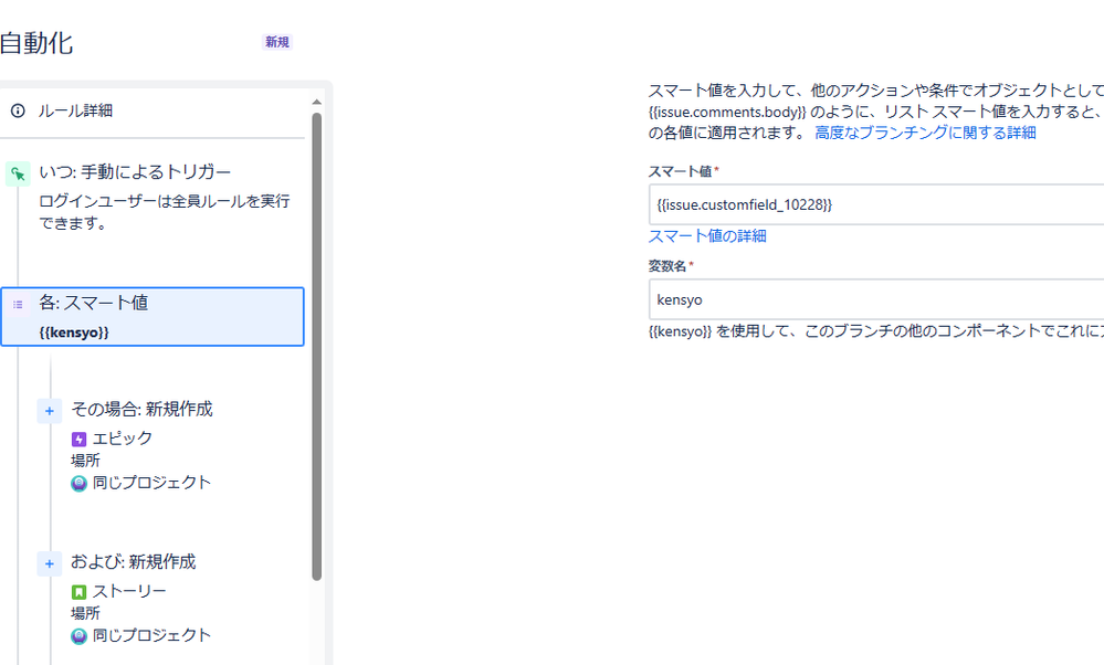

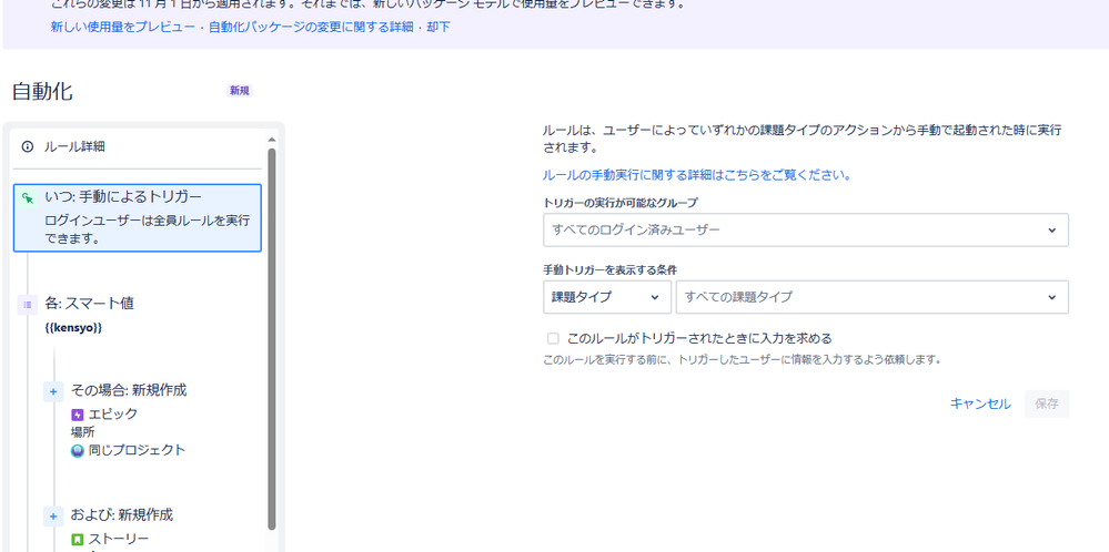

Custom Fields_10228 is of type Select List (multiple choices).

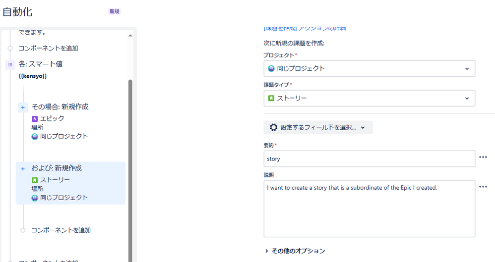

Create a tier 2 Epic below
"Parent Link" : "{{issue.parent.parent.key}}"

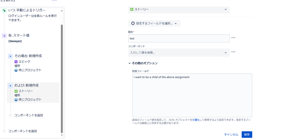

I want to create a story that is a subordinate of the Epic I created.
(I want you to tell me how to do it here)

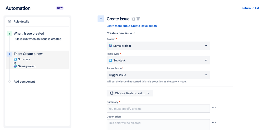

Michel Neeser
October 27, 2023
Hi @koutarou ishibashi
I think you can achieve your goal with an automation rule like this:
koutarou ishibashi
October 27, 2023
Thank you for your answer. because of the special environment it cannot be created that way
As you can see in the image, we have created a new issue and created a child issue of the parent parent with "Parent Link" : "{{issue.parent.parent.key}}".
I want to create a child in the issue I created
Michel Neeser
October 30, 2023
Michel Neeser
October 30, 2023

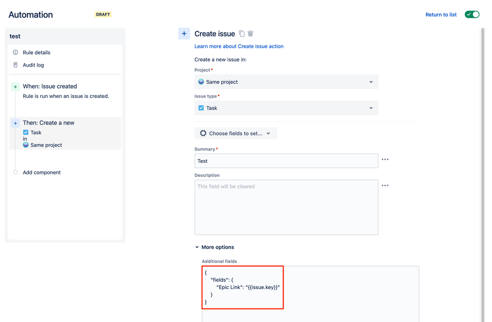

@koutarou ishibashi You have to differentiate between sub tasks and child tasks. The parent/child relationship you're referring to applies to sub tasks. But it seems that you want to create a child task below an epic task. So you have to specify the epic link like this:
koutarou ishibashi
October 30, 2023
At hierarchy level 2, we have succeeded in setting hierarchy level 3 as the parent
This is resolved
Continuing, I don't know how to set the parent of the issue I created
This problem cannot be solved
