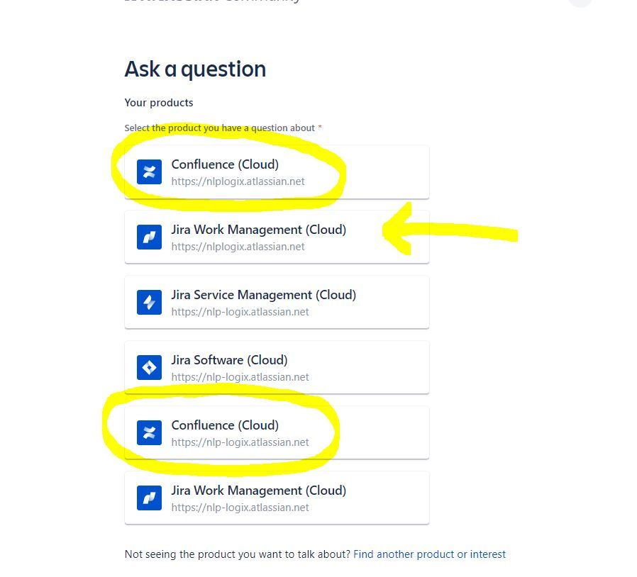

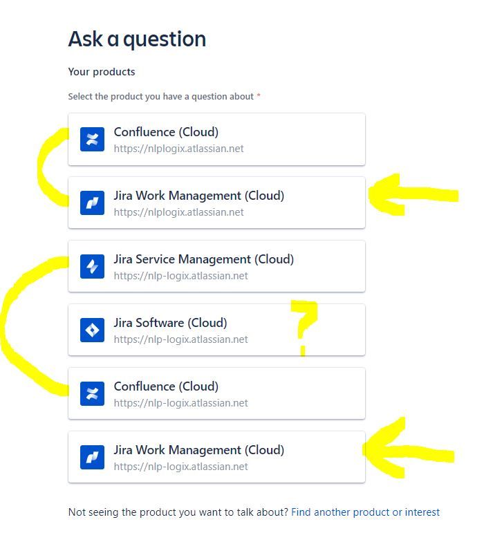

Please see the attached screen shot.  I am trying to set up knowledge base with service desk and it is not successful.  I am thinking it is because there are 2 instances.
When I go to confluence from service desk it is completely different and not where we have our documentation stored.  Please advise so we can clear up why we have 2 instances.

It will depends on which site does your Jira Service Management resides. For example, the arrow is point to the JSM on  https://nlplogix.atlassian.net, so it should be connected to the confluence on the same site which is the one above.
This also answers the question on why you have 2 instances. You have one for each site of yours.
