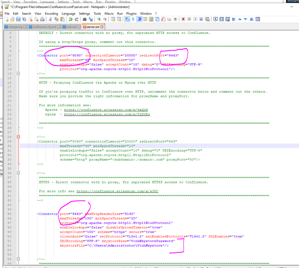

Please see my screen captures.

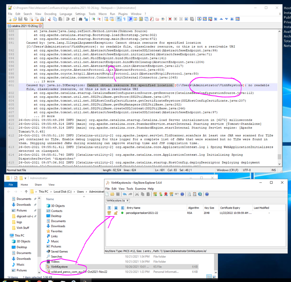

I have imported my SSL certificate in pfx format into the keystore as you can see in the screen. It is valid. The password are all valid as I tested it.
I have gone over the config files so many times in the last 4 days.
I have rebooted the server etc.
Note: It runs perfectly with localhost:8090 but as soon as I added configurations for Https it just spit the dummy.

Yes i ve read that . I have imported it into keystore as you can see in the screen capture
But it just didnot recognise my keystore file

If you configure the keystoreFile path as "C:\Users\Administrator\VinhKeystore.ks does that make any difference?

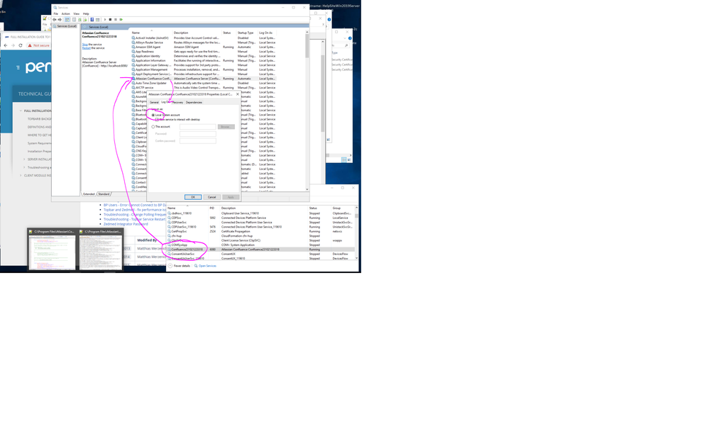

I have seemed to solve this issue.
Since it is started by Windows services, I had to change Confluence service log on to be run as local system account. This seems to allow it to access the folder c:\users\administrator\my-ssl-cert.pfx  file.
